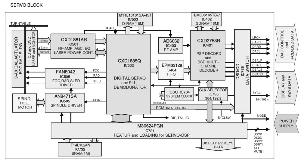

Hi Glen,
No, it's not clumsy at all. The transport is very fast in reading the TOC and skipping tracks. It is a DVD transport though, there are some Marantz and Denon models that use it. The servo and decoder chip both have some D-RAM attached to it, and there's also a FIFO between them that's clocked by MCLK. So it seems to me the data is buffered and reclocked into the decoder by the FIFO.
I dare to say the SA7001/8400 will beat any CD63/67 when properly modded . They offer more resolution and detail, great depth in the soundstage. These players go sky-high with a proper clock and outputstage. I had to change my tweeters and interconnects to unleash their full potential . I'm actually thinking about selling one of my CD67s, because I never use it anymore...
Ray

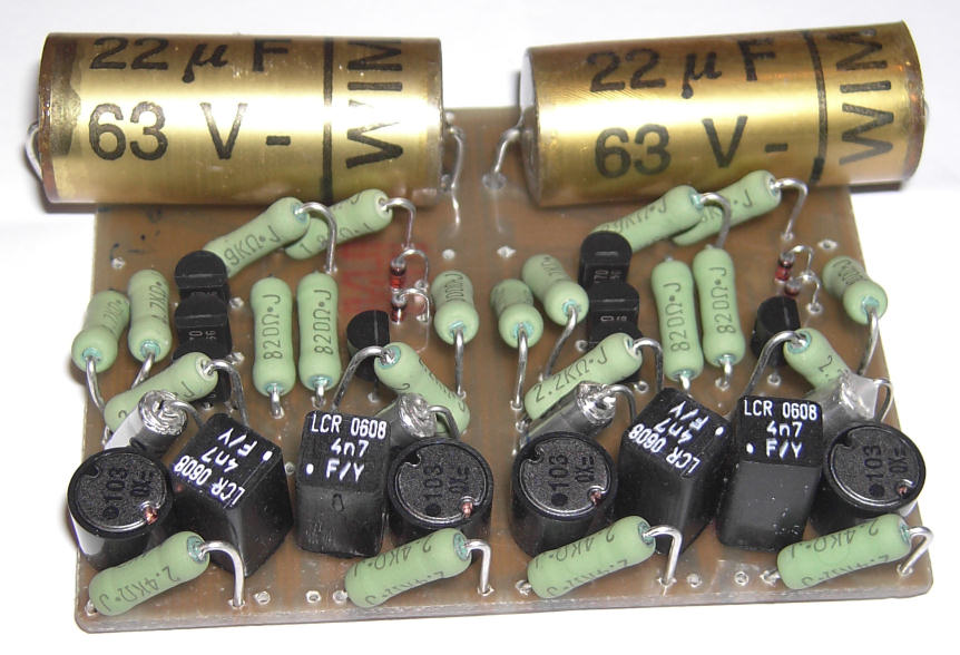

SimontY said:Evening all,
I soldered in my resistors this evening (see pic). They sent me 470R instead of 470K, which is annoying. So it's nearly complete. I'll sort out mounting some voltage regs tomorrow and hopefully get a successful test done!
Excellent - it also looks like you have the transistors the right way round too
Brent
Brent
Excellent! And the diodes?
