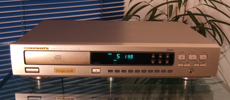

MARANTZ CD 63
MARANTZ CD 63 cd player You can see on: http://www.audio-extasa.eu/product_info.php?cPath=23&products_id=562
Re: MARANTZ CD 63
The picture is actually a CD-67MKII OSE.
I prefer the black ones personally! 🙂
audio-extasa said:MARANTZ CD 63 cd player You can see on: http://www.audio-extasa.eu/product_info.php?cPath=23&products_id=562
