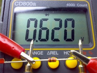

6h5c said:
Which zener values did you use?
Ray [/B]
Hi Ray,
3.3 V, when I hook up with DMM actually 0.6 V :bawling:
First, in the adj pin I put green led seri with zener, DMM meter read 4.3 V .........so I added zener again (zener-zener-LED) and DMM meter read 4.94 V.......is that right ?
Regards
aquar

aquar said:
Hi Ray,
Regards
aquar
Hi Aquar,
You can't measure the reverse zener voltage with a DMM. The reading you get is the normal forward diode voltage. Try and reverse the zener in the regulator circuit, it seems you have it connected it forward now.
Ray

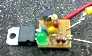

6h5c said:
Hi Aquar,
Ray
Ouuups.....I'm sory.
BTW, this morning I measured in the reg. circuit (running with 12V DC suplly) and I got:
1. Output = 4.94 V
2. Between zener - ground = 0.8 V (2 zener in seri = 1.6 V)
3. Between LED - zener (LED pin+ / LED pin-) = 2.1 V
4. Between adj.pin - ground = 3.7V
Here is the pic ( sory with a bit blur.....by phone cellular)
