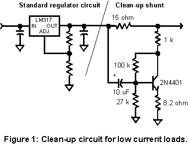

6h5c said:
Hi Aquar,
Hm, that's not right. The output voltage should be constant, independent of the input voltage. Are you sure you used the correct pinning of the regulator (ADJ - OUT - IN for LM317)? With 150 ohm there's over 8mA going through the LEDs, should be plenty to make them light. Something is probably not connected properly.
Ray
Hi Ray,
I will check again.
One question:
I found 'clean up shunt' from Wenzel associates, What your opinion if I combine with 5V/12V raygulator ?
Regards
aquar

That circuit does work, but it needs very careful trimming to get the best noise rejection.I found 'clean up shunt' from Wenzel associates, What your opinion if I combine with 5V/12V raygulator ?
It also sounds grim!
Lowest noise out of a regulator seems to be a lot less important than its dynamic response (maintaining low impedance over the audio band). The shunt delivers low noise at the cost of rather high impedance in the supply... not good for audio, though very useful for many instrumentation uses.
