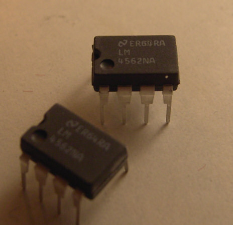

Well, I got mine (LM4562) today. I installed them in my preamp this evening... initially pleasant but I felt the sound was lacklustre and a bit soft. Then I realised one of my noobish housemates had turned my cd63 down with the digital control!! I'm using them for two gain stages (may sound slightly different in CD63, yet to try) and they are replacing the now very familar LM6172.
The 4562 is more laid back, less etched and aggressive, softer, not lacking in detail at all, and it seems to image better. Vocals are definately a strong point. Bass is a touch reticent after the heavy-handed LM6172, but I think this sound is a lower distortion one. I'd have to check back but these initially seem better than OPA2132/4 and LM6172 (and of course cr@p like OPA2604).
For those wanting a superior sound that is very listenable and in a handy dual package, try these out with the sample program, I think you'll like them.

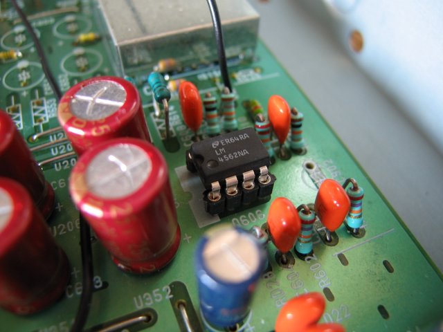

Ive just modded a 63KI for a customer and used his NAIM SNAPS PSU for the DAC and Decoder voltages. I did mod the Naim psu by fitting a better lower esr main smoothing cap and added extra bypassing to circuit.
The cd player benefits from pana fc and silmics through out with everycap bypassed. Star earth , Hdam and caps bypassed with relay muting circuit. Op amps are just OPA2134 (for now). Well all the usual bobbins that works
The sound is very laid back with good clean vocals a well extended bass. Much better than I thought it would be.
Its got me thinking of modding a CD17KI and using two modded Naim psu to run the extra voltage rails etc. mmmmmm
Brent

poynton said:Hi.
Although the principle of psu improvement is well known, my concern with this arrangement is the extra connectors and lead length.
Andy
I agree to a certain extent. Of course Naim can't be doing things too badly.
This is definatly and improvement in audio over a small pcb with 4 regs and small toroid, trust me i've built an millions (err alot anyway lol) I'm sure if i could squeeze this psu into the unit then the benefits would be greater. This psu does have a rather large Toroid in it.
So basically two identical psu with one inside and one external the internal one will give better gains. But a good external will be better than an average internal IMHO
Brent
