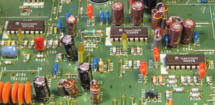

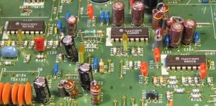

These are the orange 0.1uF and 0.047uF capacitors in the digital / transport control section. I replaced them with RIFA PHE426 series (same value) and the player didn't work with these RIFAs.
You mean like the three orange ones around the TCA? Very strange. Maybe the player doesn't like RIFA :D.
Ray
Ray
Yes, these caps.
quantran said:
Yes, these caps.
Nice photo's, Quan. I can't explain why the player behaves so strange just by swapping those caps. It never occurred with the players i've done so far.

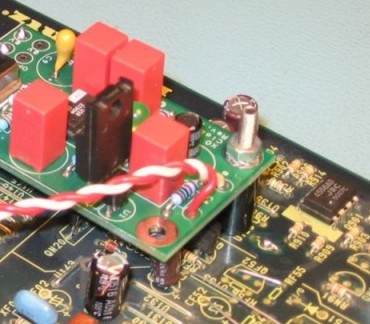

ImSparticus said:
I used hot melt glue also, not sure what everyone else uses to mount their bits ?
Plastic pcb supports are good, worthwhile keeping some of these to hand, like the ones you can cut to size.
When mounting other than horizontal, watch all those electrons dont run to the bottom :cannotbe:
Bolt them electrons down man, can't have 'm running around! :D

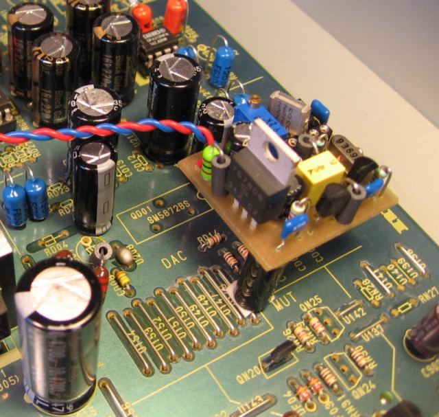

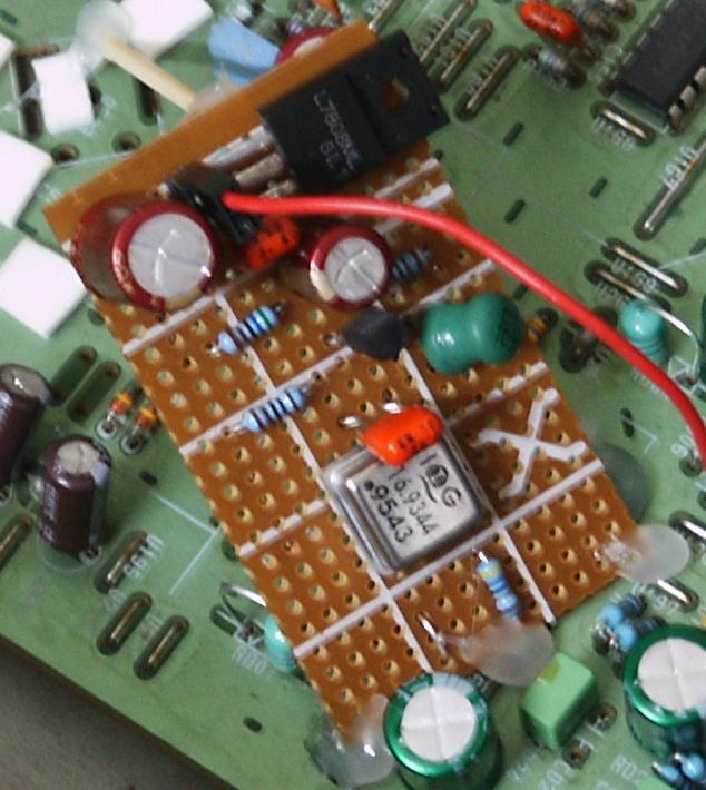

7. Replace the clock with Elso's Kwak Clock 7 PCB (can build yourself quite cheap) or LC audio XO3 clock $450 or (much cheaper, perform clockerectomy as per http://db.audioasylum.com/cgi/m.mpl?forum=tweaks&n=20123&highlight=Cheap&r=&session= and "Clock Mod" at http://www.acoustica.org.uk/t/63/63hacks.html.
