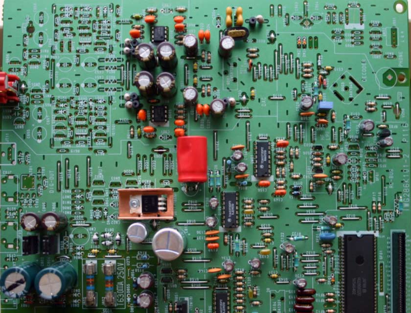

Muting Transistors, is it just a matter of removing QN05-08, QN24/25/91/92 and RN27/28?
Remove QN05-08 and RN27/28. Remove ALL of the headphone circuitry.

YoungSC said:I'm looking for someone to hold my hand.
I know Ray suggests some extra things relating to grounding etc. Is this necessary, or can I just get away with the above?
Basically QN05...08 are the ones to remove to disable muting on the RCA output, and QN91/92 for the headphone circuit. If you do this both, you can also take out the driver transistors QN24/25 and two resistors that feed the muting lines (RN27/28). If you never use a headphone, you can disable the circuit by removing C901/902 and two wire links that provide +/- 12V to the circuit (U271/272).
By grounding the left-over traces you can lower the amount of interference radiated into the analog circuit. I used 100n ceramics because I use the muting lines to drive a muting relais, but you can use wire links directly to ground if you don't have that.
Ray

6h5c said:Basically QN05...08 are the ones to remove to disable muting on the RCA output, and QN91/92 for the headphone circuit. If you do this both, you can also take out the driver transistors QN24/25 and two resistors that feed the muting lines (RN27/28). If you never use a headphone, you can disable the circuit by removing C901/902 and two wire links that provide +/- 12V to the circuit (U271/272).
Ray

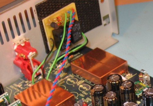

rowemeister said:Ray I also see you use muting relays, i love the click you get between tracks.
Brent
Yes
Ray

6h5c said:
Yes! It's the ultimate solution for me. No clicks and pops during power-up, and the audiophile 'click' between the tracks is very sophisticated 😀.
Ray

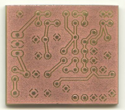

Is that a home-made pcb, Ray?
Andy

poynton said:Is that a home-made pcb, Ray?
Andy
Yep !
Just like the clock-PCB.

Well, my workingspace is quite small and parts are everywhere but where expected 🙂
6h5c said:Yep !
