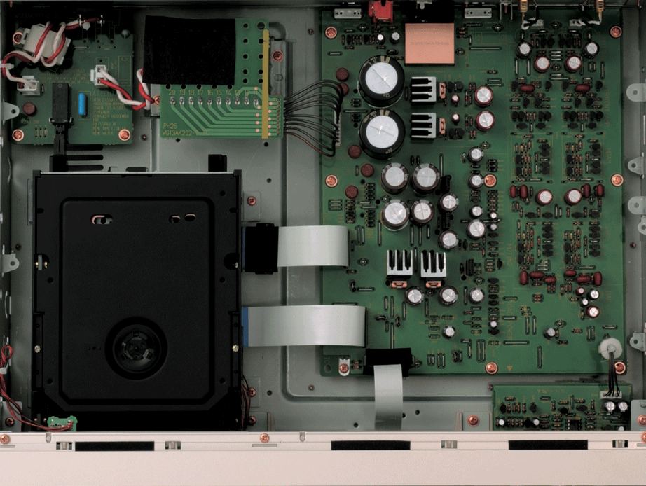

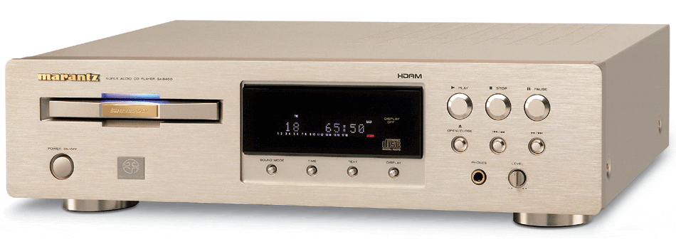

Hey, our thread has almost moved to the third page! Time for a new post, allthough it's a bit off-topic: I've got a new toy 😀 !!
Let's see if a HDAM-bypass-procedure has as much impact as it has on a 67 😀 😀.
Ray

avr300 said:
Nice player Ray, lets see it under the hood.
Here's a nudie picture 🙂
Lot's of caps, more voltage regs and ferrite shielding around the flatcables. The servo and driver electronics is mounted on a PCB under the transport. So the PCB is mainly PSU, DAC and analog. The digital-out is nicely shielded under a HDAM can. And: no opamps!
This pic is from the Marantz website, there are actually three cans in the player.
Ray
