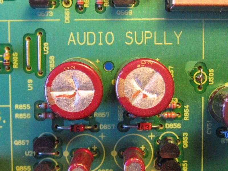

6h5c said:Here's a nudie picture
Lot's of caps, more voltage regs and ferrite shielding around the flatcables. The servo and driver electronics is mounted on a PCB under the transport. So the PCB is mainly PSU, DAC and analog. The digital-out is nicely shielded under a HDAM can. And: no opamps!
This pic is from the Marantz website, there are actually three cans in the player.

6h5c said:Hey, our thread has almost moved to the third page! Time for a new post, allthough it's a bit off-topic: I've got a new toy !!
Let's see if a HDAM-bypass-procedure has as much impact as it has on a 67 .
Ray

I finally found some time to listen to it last night, and the player beats both my modded 57 and 67 by a considerable margin. The 57 has the discrete FET output and the 67 uses opamps, and both have Flea clocks. I know these players are not as heavily modded as possible, but I think it's going to be hard to reach the same level. With 'normal' CD's the 8400 gives more detail, and the soundstage has more depth. With SACD the differences become even bigger, again more detail and definition, and overall the sound is more relaxed and controlled. I find the sound a tiny bit too bright, mainly in CD mode, but you can clearly hear the good points. Like a diamond in the rough, waiting to be polished .
Ray

Hi Allan,
It's a SA8400, and it uses a CS4397 from Crystal. It has a switched capacitor network on board, which is supposed to be a bad thing for the sound. But I am wondering how good or bad a modern DAC like this can be, so I didn't let that scare me. I'm going to tweak it step-by-step and listen very carefuly to the results, and I hope my verdict will be positive in the end .
