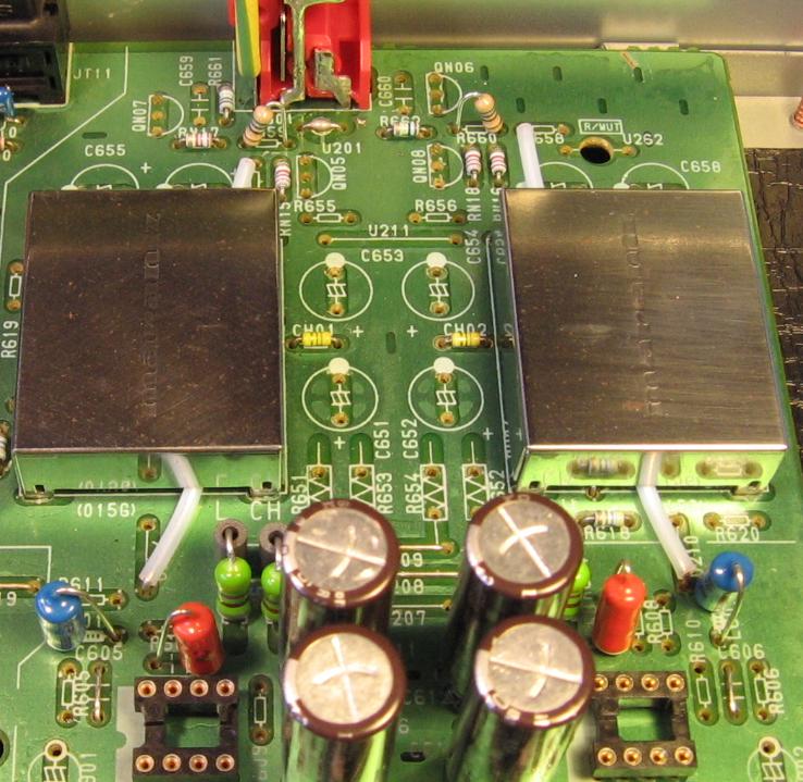

am new on this forum today am just modding my 63se have disabled the muting circuit i think removed qn05-08 will this do it? or will i have to do more? am now disabling the hdam cicuit have located all resistors except rh23 rh24 can`t seem to find these on my board been looking for hours any help will be most welcome,
Originally posted by rowemeister
Disable muting circuit: remove QN05...08, QN24/25/91/92 and RN27/28 (cuts analog -12V to muting
circuit). Remove U207 and U262 and cut trace there to disable traces running to headphone section.
Decouple each muting line to GND with 2x 100n/X7R at junctions U222/223 and output side to remove
noise coupled-in to analog section from digital-out that runs in parallel with muting lines for several inches!!
the HDAM-circuit looks nice, but when moving up to better opamps and interconnects this circuit starts to
interfere and degrades sound quality. To disable HDAM: remove R651...654 (+/- 12V), R617/618 and
RH23/24. Insert wire jumper at R619/620.
thanks in advance, mik

Hi Mik,
Welcome to this thread. I hope you enjoy modding your '63. It's very rewarding and addictive 😀.
The two resistors you mention (RH23/24) are situated under the HDAM shielding-cans. They are the output resistors of this circuit. Hint: if you also remove the output capacitors (C655...685) and U210/214 you can leave them in place and insert a wire between these two points. This way you'll bridge everything with one jumper.
Ray.

thanks ray, a couple of things,
is that all output capacitors between c655 and c685 or just these two?
also i notice that c651 to 654 are missing do i remove these too?
does that bit of wire run from u210 to r658 and from u214 to r657?
i am very new to this modding lark, first timer!!!!!!!!!!
i have a cd63 which skips a bit when cold only cost me £10 so am going to use this to practice on haha having read in your back posts this is probably cauased by the grease going hard? so might fix that too
have ordered two opamps opa2604(ap) which i am going to run in class A which invloves putting a resistor (3.6k 1/4 Watt carbon film) between pins 1&4 4&7, is this a good thing or will the opamps run to hot? ie will i need heatsinks?
