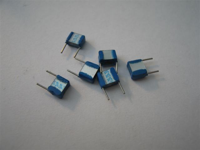

Do you recall these. I can't remember the type.

Malefoda said:
Thanks for answering!
but...
I think I've just discovered that PPS stands for "Polyphenylene sulphide"... wich are out of stock with no offered alternative!
This is my fate...
http://fr.farnell.com/jsp/endecaSearch/partDetail.jsp?SKU=3891010&N=0
Hi Malefoda,
Try these:
969-5532
Try to use the parametric selection: first select composants passifs, condensateurs, then PPS and select the value or other parameters. This way you can narrow down to the desired type. Beware that 100n is also written as 0,1uF or 0,10uF.
Ray.
Thanks Jaap & Ray!
... but ( yes again... )
47R show 346 things, many resistor types... I know nothing about electronic, except the soldering tool is hot and burnin', and 230V quite dangerous...
Also for this fu.... 0,1uf caps for the AD8620 PS bypass, no way to find even if goes through caps/pps/0,1u or 0,10u or 100n... just the non avalaible Rifa or the small square Panasonic ( as the ones Ray introduce to bypass under the PCB ) useless to jump over the opamp IC...
And what is 1uf MKT ? This (found with MKT search and then selector)?
http://fr.farnell.com/jsp/endecaSearch/partDetail.jsp?SKU=9750932&N=401
These are the 3 missing ref at farnell to order!
Heeeeeeeeeeeelp!

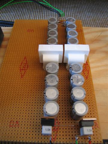

Opamp power supply
Got it running now, with C-LL-C network and no caps after the regs, just the local caps at opamp end. It's ver. 1 proto type. Had a LOT of these 220u, 25V unknown spec. and the more in par. the lower impedance. Can't get this big supply bolted into the cabinet, no space left in here, so I think it will be an offshore solution.
It has got even more control now, is more punchy, better timing, is just better. I would say that this is the single most effective mod I have done until now (and now I get flamed!! :hot: )
Thanks Jaap for bringing it up again (and staying in on it), and to Brent, think he was the 1. to write about it (hey, it's so long ago that I had forgotten it).

Re: Opamp power supply
Looks delightfully DIY, harhar, but it serves its purpose!
If you are able -once- try two BG NX in super E-cap instead of each 1.000uF, you'll be surprised again. Enjoy!
Jaap
Are those white boxes between the caps the chokes?? What kind are you using?? Im going to be building an outboard supply soon. I plan on building a +-12v and two 5v supplies one each for the analog and digital to power the dac/decoder/clock. Do you know of any good websites about building audio power supplies?? Ive been reading this
tnt audio power supply info
which is for an amplifier power supply, but I would think the info here applies to all audio supplies. Theres also some interesting info on voltage regulators on that website. Any others you guys know about that will help me design my power supply?? I know the basics, but would like to learn as much as possible.
