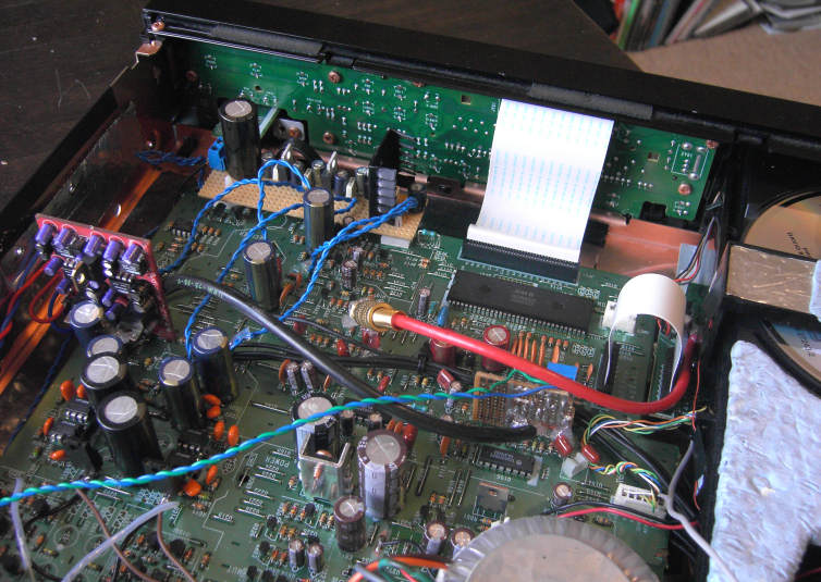

It does look nice. How is the pcb connected to the other?
Do we have different views
Brent
You must have to jumper 2 small wires from the two holes next two the .o1 caps on each board?

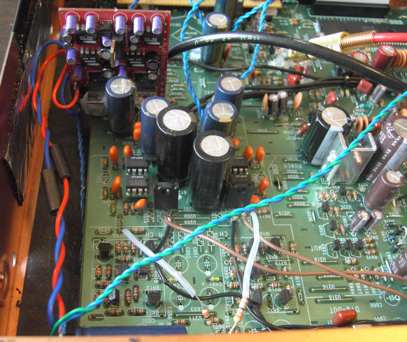

At a first look the LM317 on the left is a CCS at 12,5mA. The LM317 on the right should give 5V. Hmmm, what's that IC doing?

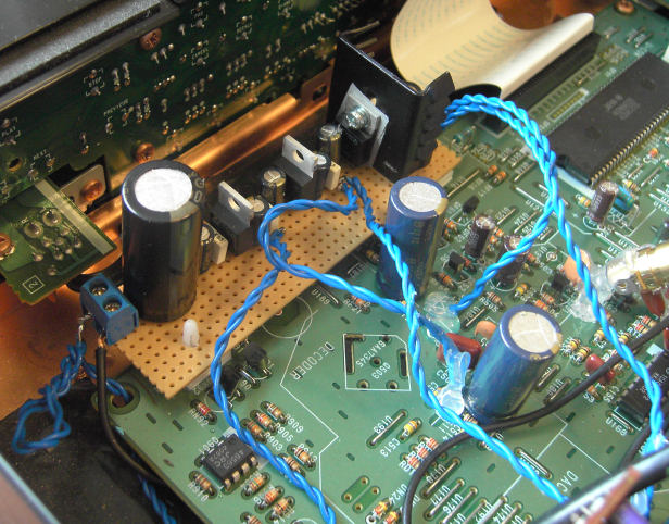

Here's a closeup of the regulator board. The heatsinked reg gets quite warm so it's been treated to some cooling. The big cap is BG Standard 1000uF and the little ones are Panasonic FC 33uF, the very little ones are 22nF polyester
What kind of regulators are you using on that board? Looks easy enough, maybe I will try it.

imperfectcircle said:What kind of regulators are you using on that board? Looks easy enough, maybe I will try it.
Just "jellybean" 7805. They'll be upgraded at some point in the future I'd imagine, but they work well enough (good improvement on the single shared 7805 as per stock).

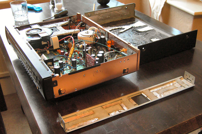

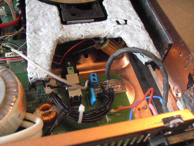

This is where ground is routed! A couple are detatchable: for reg board and transport/mech section. The bigger wire links it to the IEC socket I added. The large resistor reduces the voltage for the twin blue LEDs (which shine across the disc). Also you can see the choke for live and neutral. That bluetac is pointless I think lol
rowemeister said:It all looks very familiar 😀
Brent
Hehe, well I guess it would, as you rebuilt it for me. Credit where credit's due! This sounds superb! Thanks Brenton 😀

In case you didn't use low drop regulators (LT108X series) and are feeding from the +20 rails, that's where your heat comes from.
Maybe it's wise to have an extra tranny for the 5V supplies, of say 7V. That would give out app 8.5Vdc (with Schottkies), just enough to feed your regs.
Regards, Jaap

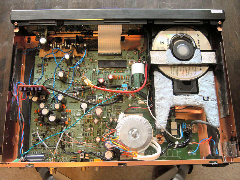

Cheers Jaap, I am planning to install some trannies and rectifiers (schottkies) in a metal box and attach this via some wires and a DIN connector. The clock psu is external already so I might aswell put it in a bigger box with more useful things and supercharge it all over again!

I often use the +20v for the 7805 regs on other players and they never usually get hot. bizzare.
On my player and other uber mod players I usually use a nuvotem toroidal 9V tx.
