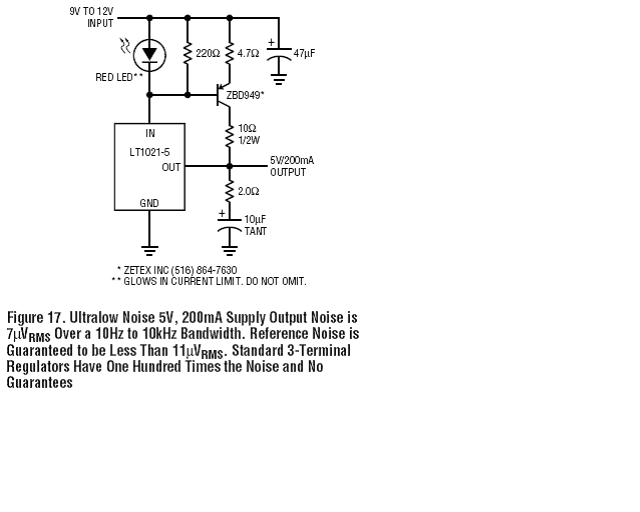

Ultra-Low noise 5V PSU
imperfectcircle said:
What do you guys think of the lt1085 regs compared to the lm7805?
I can't recall where I got this circuit from, but it seems to be a good one for the 5V clock supply (and/or for DAC analog/digital supplies, Servo supply, Digital Filter analog/digital supplies).
Thoughts anyone?

Re: Ultra-Low noise 5V PSU
Thoughts anyone?
Well, Linear Technology is known for state of the art components. The 10KHz Output Voltage Noise is indeed low (6,5uV RMS), 100KHz would probably be 15uV RMS for LT1021-5. Price could be a consideration (my supplier doesn't stock 'm).
Regards, Jaap
NB Demands for a ref voltage are higher than for a regulator. Normally they aren't able to handle currents over 10mA, that's why the help of the ZBD949 transistor.

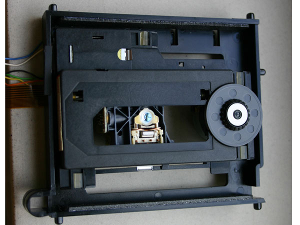

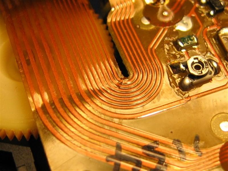

Some total i.... has tried in the past to fix my "new" CD53 and has ruined the ribbon leading to the laser hence focus error now. :dead:
Anyone of you guys have a working spare you could - ehhh - spare 😉
I ordered a laser from Grandata and it was used. So i sent it back!!
Can you not run some thin wire to the points were the cable connects. It should be easy enough.
Also try these
http://www.dalbani.co.uk/electronic_components/cd_laser_pickups.php?p=5|
Brent
