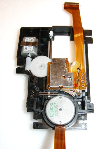

CD63KI CDM Replacement
Thanks Ray,
I will give the local Philips distributors a call and see if their techies have some insight into the compatibility of the VAM1250.
I see that throughout this thread a lot is mentioned about insulation of the chassis in terms of vibration etc. I am assuming that the sound/vibration from the speakers is the primary incentive for this tweek. If one were using headphones would it really still be necessary to mount the source on wooden (OAK) feet etc?
The other question I have is about the use of CAT5 cabling or CAT6 for that matter. I come from a IT background and it would probably be at the bottom of my list of mods. I dont think the quality of the cable is so good a quality (OFC etc) and if anything the only upside is resistance to interference. In that case I would rather get some good cable and twist it manually.
Your thoughts would be appreciated.
Cheers
Justin

Re: Re: Re: Re: KI 63 with KI 66 (and chums)
Well looking at this I would say NO.
The laser its self may well work but the spindle motor is a much better quality one and I do believe the control for this maybe beyond the capabilities of the 63/67. Never mind the ribbon cable from it.
Brent
6h5c said:
You're welcome Justin! I don't know the VAM1250 mechanism, it looks like it's part of the VAL1250 loader that is often used in DVD players. I don't know if it is compatible with the VAM1202, anyone else? Brent maybe?
Would make a nice replacement
Ray.
Brent

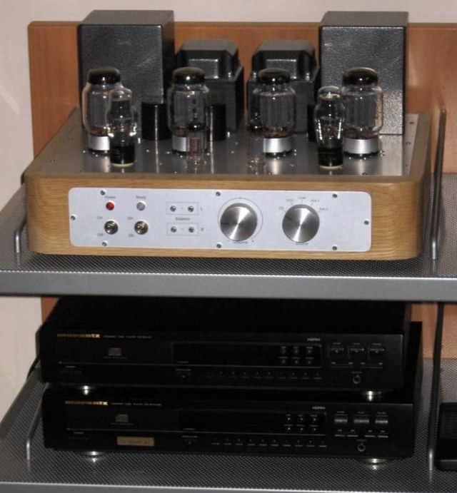

Matching the CD63KI to a valve amp?
Hi folks,
Having done quite some reading I would like to know whether a CD63KI with many of the mods and tweeks listed in this thread would be a fair match/good pairing with a valve headphone amp. I am specifically referring to a replica of the EAR mini headphone amp found here .
If you know of something similar (headphone amp) which does not necessarily have to be valve based that works very well with the CD63KI I would greatly appreciate it.
The main reason for this is because a good late night listening session does not always go down well with other family members
so I would also be looking for something a little more discrete.
Many thanks,
Justin
Hi folks,
Many thanks,
Justin
Re: Matching the CD63KI to a valve amp?
Hey, it surely is a good match with my amp 😀. Not a headphone amp though...
You should try the JJ ECC99, very nice tube for this purpose.
Ray.
Thanks Ray, your amp looks the buisness. If one had to build such an amp, how long would it take to set up etc. From the little I have read the single ended is good but expensive and the push pull has more power. If you can recommend a good thread/site to follow with respect to your amp it would be greatly appreciated.
Thanks again Jaap I will do.
Justin
Ray.
