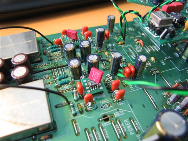

avr300 said:Just made mine Panasonic Blue. And added a few BYV95B diodes in the PSU's
Nice, looking good 😉
Re: Re: Re: What will it match ?
Ah, those good old FC's...
Nice, avr! Still using the orange film caps??? 😱 😀
Hear, hear! 😎
Ray.

I'll think they're up to the job. All the FC are bypassed with WIMA film at the bottom.
I would like to put in matched caps for the filter (the AD8620 stays! 😉 ). I do have a bunch of cheramics, so many that I can match the 100p, 120p and 1000p filter caps around the opamps - just wonder how they sounds?
Ray.
