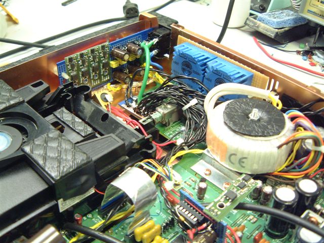

Nice HF shield (shields up!).
How's temperature inside?
Jaap
disco said:Nice HF shield (shields up!).
Thought it was but it's shade (half way the fet buffer)...
Jaap
Temp inside is pretty good. With everything running on its own psu and reg nothing is drawing much current and they all keep to a minimum temp.

Hey Rowe,
I think he meant the FETs inside the HDAM can shield. How warm are they running?
Simon
SimontY said:
Hey Rowe,
Simon
errr they are luke warm but no warmer than the standard HDAM cans get. So all is good

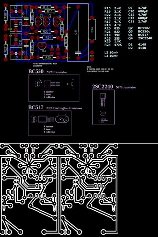

Sorry guys, but I have searched this thread for about a week now for Ray's discrete output stage schematics and simply can't find them. Could someone please point them to me as well as Jaap's PCB layout, if available.
Thanks a ton.
Thanks a ton.
Samuel Jayaraj said:Sorry guys, but I have searched this thread for about a week now for Ray's discrete output stage schematics and simply can't find them. Could someone please point them to me as well as Jaap's PCB layout, if available.
Thanks a ton.
Rays discrete output circuit
