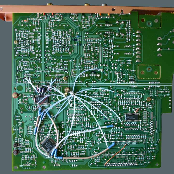

disco said:Finished the starground in one player but I was disappointed by the results. Both bass and detail are lacking compared to yesterday.
Got it!
I reversed some of the BG NX caps. These are unipolar electrolytes but need to setlle when revered. Phew.

Then I have a problem Allan. None of my hifi gear uses mains earth, not even my tubeamps. In fact, it's not present in the room.
Tried it several years ago but the amp picked up more rubbish with earth than without. Will give it another try tomorrow.
Is there still a point in maintaining the through-print-connections after making a central ground?

Just a suggestion, but maybe your house/mains earth needs attention.

Then your earth must be via the transformer to neutral.
Neutral may be connected to earth on the switchboard
Earth may be connected to the copper water pipe going to ground
or better ground stake.
Please check with the electrical standards for your country.
above is the standard for aus
"maintaining the through-print-connections after making a central ground"
Marantz used the top plane as central ground, Large area might help dissapate current pulses.
Still has to find ground somewhere!
allan

rowemeister said:Ahhh nice one glad you sorted it mate. I was really wondering what was the problem. Also if you can earth the star it will help
Brent
Hi Brent,
It took a while for the electrolytic caps to kick in, but for this purpose serves the repeat function best 😀 This morning details were back for the most part.
Thinking over the principle of a central ground I came to understand that it provides an unipotential reference. So I did a little coloring job on the layout and cut away all ground coupling jumpers but U137 (the one connecting to the upper plane). Run seperate wires to all ICs and beafed up two in the PSU to 2mm solid silver.
Well, I fired her up an hour ago and hurt my chin on the floor. Deep solid lows (organ on Donald Fagan - Ruby Baby), superb defined details (Musica Gregoriana) and a vast gain in dynamics.
Still have to connect to a mains ground [ . . . ].
Thank you Allan for bringin up this brilliant idea!
Jaap

SimontY said:Fantastic Jaap! I wondered about your lack of good sound as I heard good gains using strands of Kimber 4VS from each chip, 12v, 5v and other bits.
Simon
Hi Simon,
What helps too when one descides to cut unconnected parts of the ground: keep the connection to the RCAs as this is the only connection to the case via the backpanel. 😡
Regards, Jaap

disco said:Hi Simon,
Regards, Jaap
Yeh, I have my new RCAs connected to the ground point on the pcb just under where they sit. This point has its own star connection.
