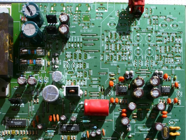

I'm planning to change the PSU, DAC and the OPAMP decoup. caps for FC's.

avr300 said:I'll buy a bunch of FC's and ZL's.
Perhaps the standard Elnas ends up being the best.

Replacing electrolytic caps is perhaps the most common repair these days as cheap caps live a short life, depending on AC load. The gold band Elnas have both better properties and useful life than the cheap stuf. Life is also prolonged when working voltage is no more than 80% of rated max voltage.
As a test I replaced the 5V reservoir cap (C815 = 3300uF/6.3V) with only 1000uF/25V BG NX, without bypass. Sonics improved considerable after 50 - 100 hours. Can recommend to everyone who works on a low budget.

Hi Jaap
I've always tried for 75%
C815,
How much of the digital circuit is this cap now supplying?
with the clock, servo, dac, etc supplied off separate reg's
what's left? microprocessor!
allan

Allan,
I have a second player, not equipped with extra PSUs.
It's my goal to mod her on a low budget and compare to the first.
Already (after bypassing critical points with SMDs and 'standard' mods) the advance of the large budget player is getting smaller.
Jaap

The removals, adding bypass caps, matching opamp resistors, changing some psu caps.
I keep the starground and coax for last because of the length of wires running across the board.
interesting idea.
remove anything that is not necessary.
only use rca out, remove everything else, cool😎
It should remove a lot of extra noise from unnecessary circuits.
and it should help the standard top ground plane also.

Hi Allan,
Yep, mica's are a spoil here as they give no noticeable progress.
Did exchange the magnetic 1M for a non magnetic Vishay and this did no good either. But one has to try... 🙂
Looking at the Remote Control at the moment (page 18).
RC-5 input (pin 15) and RC-5 output (pin 18) of MN187164 IC seem to connect through a diode. Do you think it's possible to bypass QF51 etc by connecting pins 15 and 18?
Regards, Jaap
disco said:Looking at the Remote Control at the moment (page 18).
Regards, Jaap
Yes, that's possible. I did it in both players, works fine. For CD57/67:
Disable IR remote switch and RC-5 IN/OUT bus:
- Remove CF52, DF51/52, QF51/52, QF61, RF51...56, RF61 and U133.
- Jumper collector and emitter of QF61.
- Insert wire jumper from far side of U133 (near RF03) to nearest side of RF53 that connects it to QF61.
