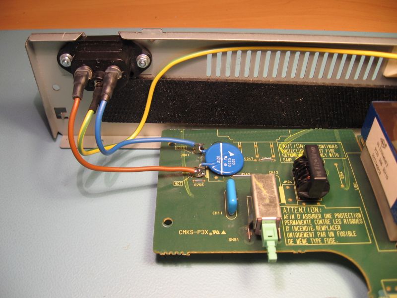

Thanks for your compliments! I always try to keep my mods neat and tidy. I pulled this pic off the Acoustica website, and that's NOT how I like it.
If you have a steady hand and a fine soldering tip you should be able to do it. I use thin low-flux solder, and I clean up afterwards with alcohol and a cotton-tip. That looks very nice compared to leaving all the residue. But I have 'a few' years of experience, so it's easy for me to say...
Ray.

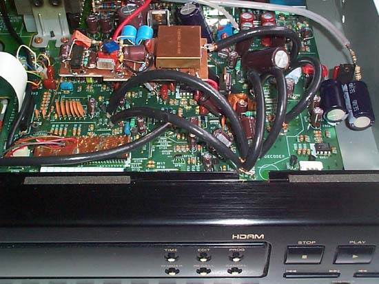

I actually like that Acoustica pic - it looks like some sort of post-apocalyptic space craft module or something! Heavily modded!

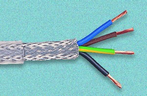

Also change the connector and / or mains cable ( I'm not sure about the use of CAT5 for mains!!!)

You know CAT5 is good for mains 😉
It is covered by an additional plastic sheath btw, so it's not too dangerous. I would not recommend this to any beginner modder tho, as it can't be the safest
But it does sound good!

Hi guys,
Just wondering - how are these wired up in relation to disassembly of the unit?
I take the back panel off to remove and work on the pcb, so hard wiring sockets on would possibly make it harder.
Can you explain how you did it? Do you remove the back panel along with the pcb?
Cheers
Hi guys,
I used a steel braid shielded cable for mains. It has five conductors, which I used like the TNT 'star' plus ground. It has a transparent sleeve, which looks very cool. The Farnell number is 385-3536 in case anyone's interested.
In my CD57/67 I disabled the digital outputs by disconnecting the +5V supply and signal. It's very easy if you remove U201 and R114 at the decoder's side.
Cool photo, rowe!
Ray.
I do. I also put an IEC socket in the backpanel that's wired, so they stay together.
