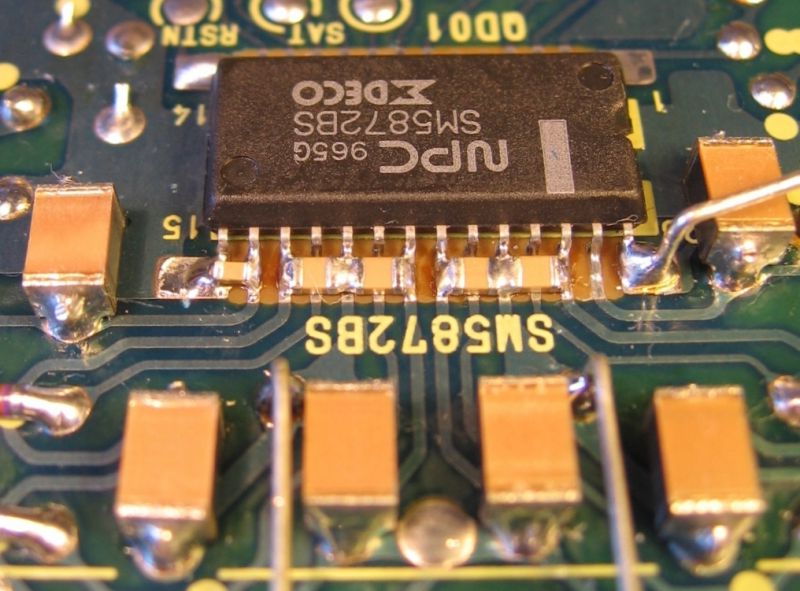

Been tinkering with my CD67 PCB today, also put some 0805 SMD caps on the DAC there. I found some really small 100n caps (0603) in the drawer, they fit perfectly between two pins, so I added one on the digital supply-pin too.
