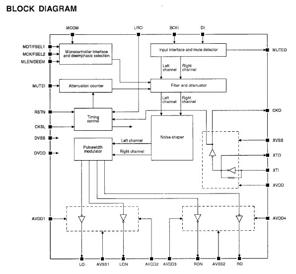

Hi rowemeister!
Some mod eh? I think you will like the OPA627 + OPA132 even better. Make sure you put the 627 after the DAC and 132 in the filter.
What Guido means is that the regs are o.k. obviously, but the noise is not coming from them, it's coming out of the DAC!
Take a look at the datasheet. The SM5872 has separate +5V lines for the digital part (pins 15 & 16), the analog part (pins 17, 19, 21, 22, 24, 26) and the clock part (pins 2 & 27). Since the supply lines of the DAC are not separated completely now, some (digital...) noise will be coupled to other (analog...) stages. If you tie the clock part to the supply of your external clock and the digital part to the +5V you use for the decoder, you can fit a third (clean) +5V for the analog part. Have I 'translated' this correctly Guido?
The key is to separate these lines. You can do that by looking at the board layout.
The clock part is just two internal gates that used to form the oscillator, but they still carry the 16,9MHz. It's easy: it is already separated, it get's +5V through RD01. You should tie it to the external clock supply to keep all the noise in one place.
The digital AND the analog part get +5V through U164. Then through RD04 to the digital part, and U200 to the analog part. If you take these two out, you have separated these parts too
Ray.

Well, I guess for the decoder you can say the same as for the DAC. The SAA7345 has three different 5V connections actually. One for the analog front-end, where the analog HF signal enters the chip, and two for digital internal logic and I/O buffers. All this wisdom came out of the datasheet of course.
I already experimented a bit with this, and placed an RC filter (1mH + 220u low-ESR) in each powerline, but the chip didn't seem to like it. I think it has to do with internal reference voltages or something like that. The chip doesn't like too high impedances between the different power lines. There's a note also about this in the datasheet.
In the CD67 (which uses a similar SAA7372) they separated the 5V lines a bit by using two RC feeds for the analog and digital part and by inserting ferrite inductors in the digital lines.
Ray.

Hi rowemeister,
So you have a separate regulator that supplies C510 (analog), and the digital C511 & 513 are connected to a second reg?
When I look at my board, C513 is connected directly to the 5V line, and C509/510 through R511. In the schematic however, C513 is connected to C511/512 and then though R508 to the 5V line. The schematic and board in the manual are different (again...) 😕
Ray.
I have seperated rails now yes. I just need to build a reg for the clock voltage i/p of the DAC.
I have just looked @ another KI pcb I have here at work and C513 is connected direct to the 5V rail.
So when I thought I had pin 15 running from my regs I was wrong!!!
I will have to change this

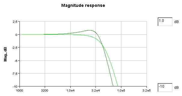

I know the TNT mod where they change the 120p cap in the analog filter, to get rid of the slight bump in the high region. But this is not the right way to do it!
Take a look at Pedja's page: http://users.verat.net/~pedjarogic/audio/cd_mods/cd_mods.htm
The idea is to lower C605/606. I use 560pF now. You can get rid of L601/602 too, they don't use it in the CD67 anymore.
If you want to simulate the filter you can use this handy tool from Analog Devices. In the diagram it will show a nice before and after graph if you fiddle around with the values a bit.
Ray.

Yep. Well, actually it's what Pedja is saying, just passin' the word
You can play around with the value and see how the curve changes. Here's a pic of the 'before' (1nF) and 'after' (560p) amplitude curve as it comes out of the Analog Devices tool.
It's a simple mod, i'm curious what you think of the sound.
Ray.
