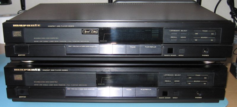

One of them is a Special Edition. The differences: it's stuffed with Cerafines and two NE5532 instead of LM833 opamps, can you believe that!
I hooked it up and it sounds great actually! The music is very calm and relaxed, but not laid back or veiled. The soundstage stays a bit between the speakers though. I like my CD67 better, but this is unexpected! Looks very promising. Maybe i'm infected with the 1541 virus now. Next thing you know i'm into non-OS!!

Excellent Ray.
Looks like a good player to mod.

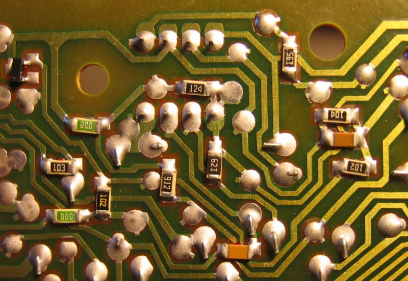

6h5c said:Well, what do you know, it has SMD too! Looks like they had to hand-solder it all together 😀.
Anyone happen to have a service manual of this model?
I'd be very grateful to have a few scanned pages.
Ray.

Ahhh the old Philips pcb layout. I used to repair those.
Brent

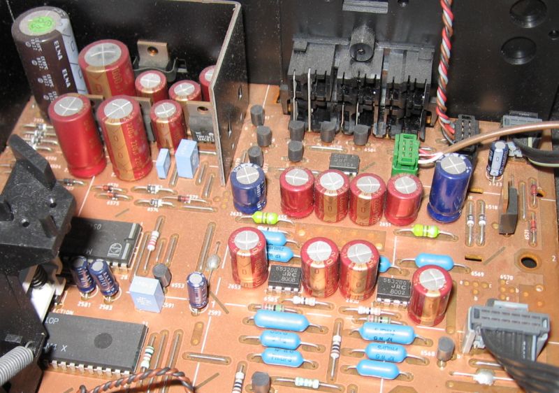

SimontY said:![]()
update: sounding sweet as a nut and lifelike, but some noise from left channel, lol![]()

Sound from both mate, but slightly excessive noise from L-CH. I'll take it apart when it's less sunny and see if there's anything obviously wrong. What things could possible cause a lot of noise?

There could be a dry joint on DAC etc.
Try swapping opamps over also.
Explain the noise for others mate.

Thanks, it's quite broadband and steady, sounds random, like white noise, all frequencies. Audible at listening seat at medium-high levels on v. quiet passages or paused/stopped.
Si
edit: also the image is skewed to the left (otherwise sounds stunning)
