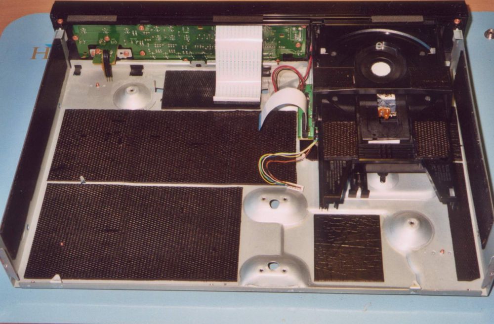

Rein said:I started to read this tpic, but already very soon it got to difficult for me. Perhaps time to start a topic for those like me who have not the knowledge others have.
Just another question, isn't there a Dutch "modder" in Limburg. Just to have th epossibility to see one time what has been done. By the way, I did not went shopping yet. The bitum, do you have to glue it on the inside of the top en the sides?
Rein.
Hallo Rein,
If you need some assistance (in dutch), just drop me an e-mail.
Unfortunately for you I am in Noord-Holland, but you are welcome
I have taken a lot of pictures during my mods that could be of help.
Groeten,
Raymond.

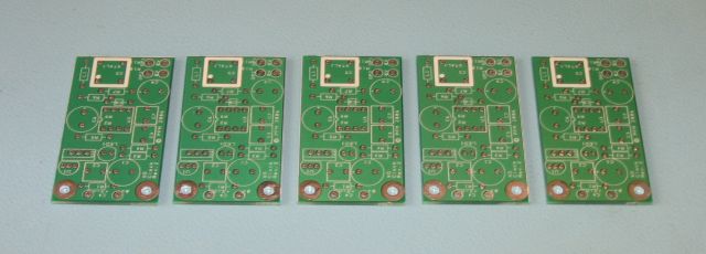

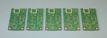

Are those Trent clock pcb's your using for the reg's?
Nice work looks cool.
Dave

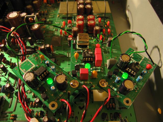

avr300 said:Like this?
I was more thinking of inserting one 7805 to feed the dac
Really you need 3 7805 mate. One for the digital supply one for the analogue supply and one for the voltage reference for the clock. Also supply the decoder from these too.
Here is a very basic way of doing it.
gy21 said:I'm thinking of putting in a separate reg (7805) for the dac. Does anyone have a more detailed description of how to do this?
You need a few things, and need to decide how far to take it. Do you want a separate reg for each of digital, analogue and clock reference? I think you do...
Basically, you need:
3x 7805
a strip of veroboard/stripboard about 5 strips wide and about 5" long
wire not too thick to be inserted through pcb holes (stranded would be the easier)
2 caps for each reg (one before, one after)
possibly some screwdown terminals to allow removal of the power input for repair/work (your choice, but I like that idea)
You need to know:
*Where to take the voltage from (I used the +20v supply from)under C803.
*What parts to remove (RD01 and RD04)
*Where to feed the new 5v rails (U200 - lifted at the supply end will feed the DAC's analogue psu pins, hole of RD04 for digital psu pins, and hole of RD01 for clock ref. pin)
This post of mine has a pic showing more or less where they go and what it might all look like: http://www.diyaudio.com/forums/showthread.php?postid=910675#post910675
Also - you need to attach the ground of the regulator and associated caps to the ground of the player, in my case a star ground I added.
edit: or do it even more simply as Brent has shown above (fewer caps).
