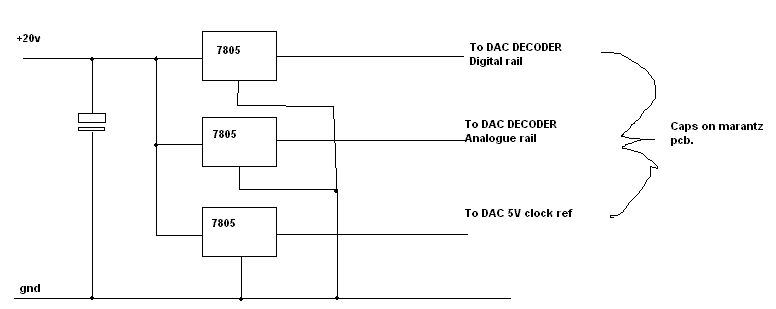

A question about the same output filter: In the original Double-pole Multiple-feedback active filter topology, there is no inductance, like L601. What it does is, it adds a zero at around 400 kHz and obviously the attenuation of the DAC noise at higher frequencies is much lower than without it. This frequency corresponds well with the DAC sampling frequency, being 44.1 kHz X 8 times oversampling = 352.8 kHz. Do you have any clue why the designers have done it?
There have been much discussions about 5V regulators around the DAC, and I would like to share some of the things I have done. I use a single regulator for the digital section and two 5V regs for each of the analog channels. As you can see on the CD63 schematic, by removing some connections you can supply separate power to each of the audio channels and the ground connections of the right and left analog sections originally go to the star point separatelly - probably to avoid any possible crosstalk. I don't remember now quite well, but there was a chance that by installing a single reg for two channels, when connecting the ground to both of them, a ground loop is created extending to the star point. Therefore I removed the ground connections to the star point by removing some of the jumpers, and replaced them with the ground connections from the reg, taken from the 10V supply taken in a single point. Has anybody else done the same "mass"?

Very interesting Petar. I didn't touch the ground there and I used a single 7805 to feed all 4 analogue pins. Maybe this is something I should improve...
Si

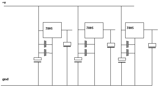

One more question
all three inputs for the 7805 can be connected to each other? same for grounds? only the output must be separated from each other.
correct?
gy21 said:
One more question
correct?
Yes
Ideally seperate psu for each is much better but lets start simple.
Here is a simple diagram
rowemeister said:
Yes
Brent

That sounds good, but not especially practicable. My star earth board is already getting a bit impossible to manage with so many thick wires soldered to it
Simon
Just a noobie thought inspired by the earthing on the CD63, but would there be any merit in creating a local star earth point for the regs on the reg board?
So you'd have each one wired to one spot but not sharing a strip on the veroboard. Then the star would go to the main star.
