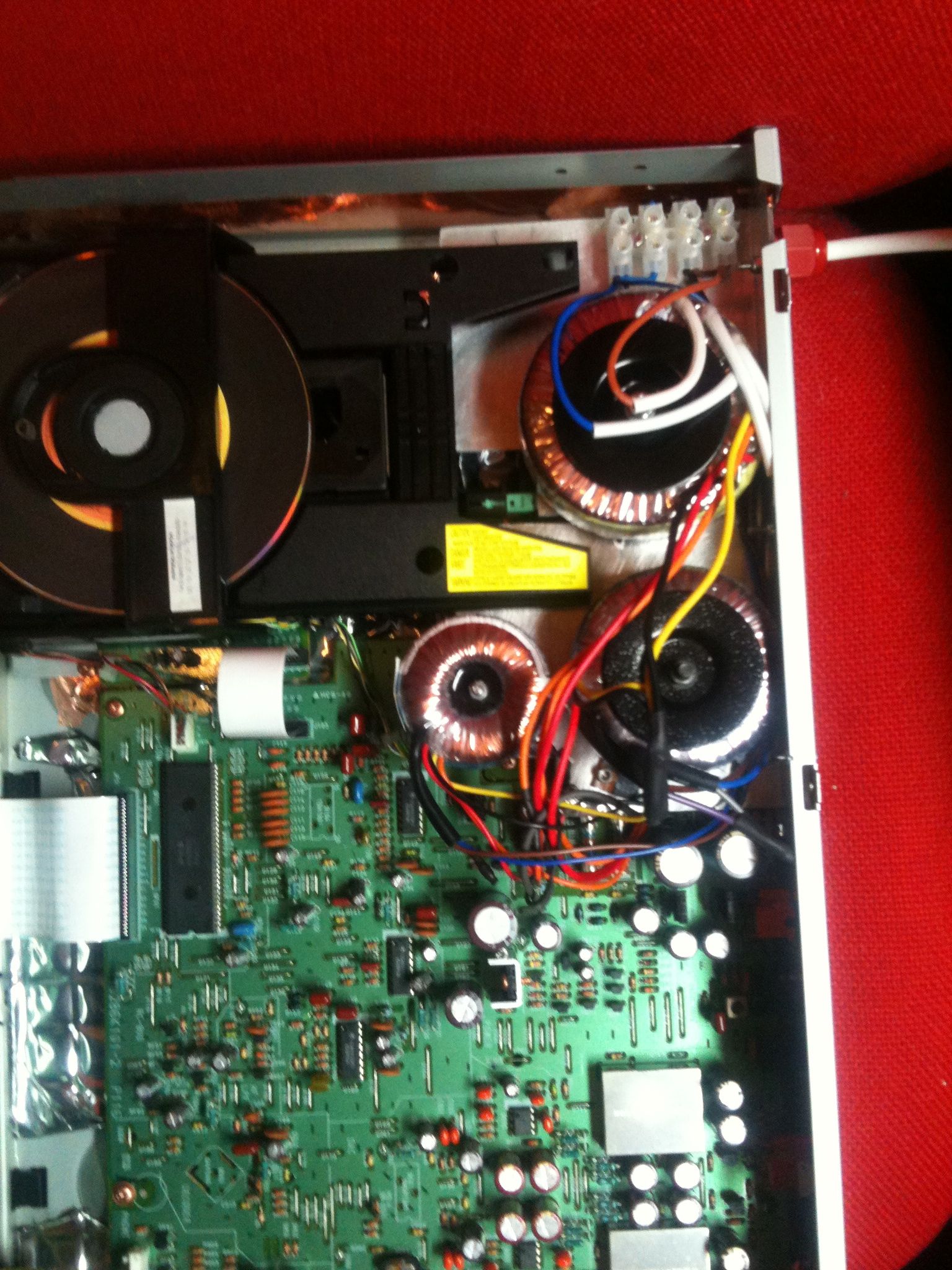

Hi, I am just trying to mount the three toroidals for Higlanders mod and was wondering whether I can just mount them on the outside of the back of the chassis. They are not in plastic cases so would this be safe? It would certainly be a lot easier than building a little platform and squeezing them behind the transport. Thanks! Henry
They should really be inside the case for safety reasons. The plastic film on the outside is so easy to scratch off exposing the windings.
But isn't the primary winding underneath the secondary? In other words, one would have to penetrate through a layer of insulation, then secondary winding, then another layer of insulation to reach the 240V winding. Am I just being naive? Henry
I got the transformers slotted in and it sounds good. Next is Ray's DOS-CFP. Henry
