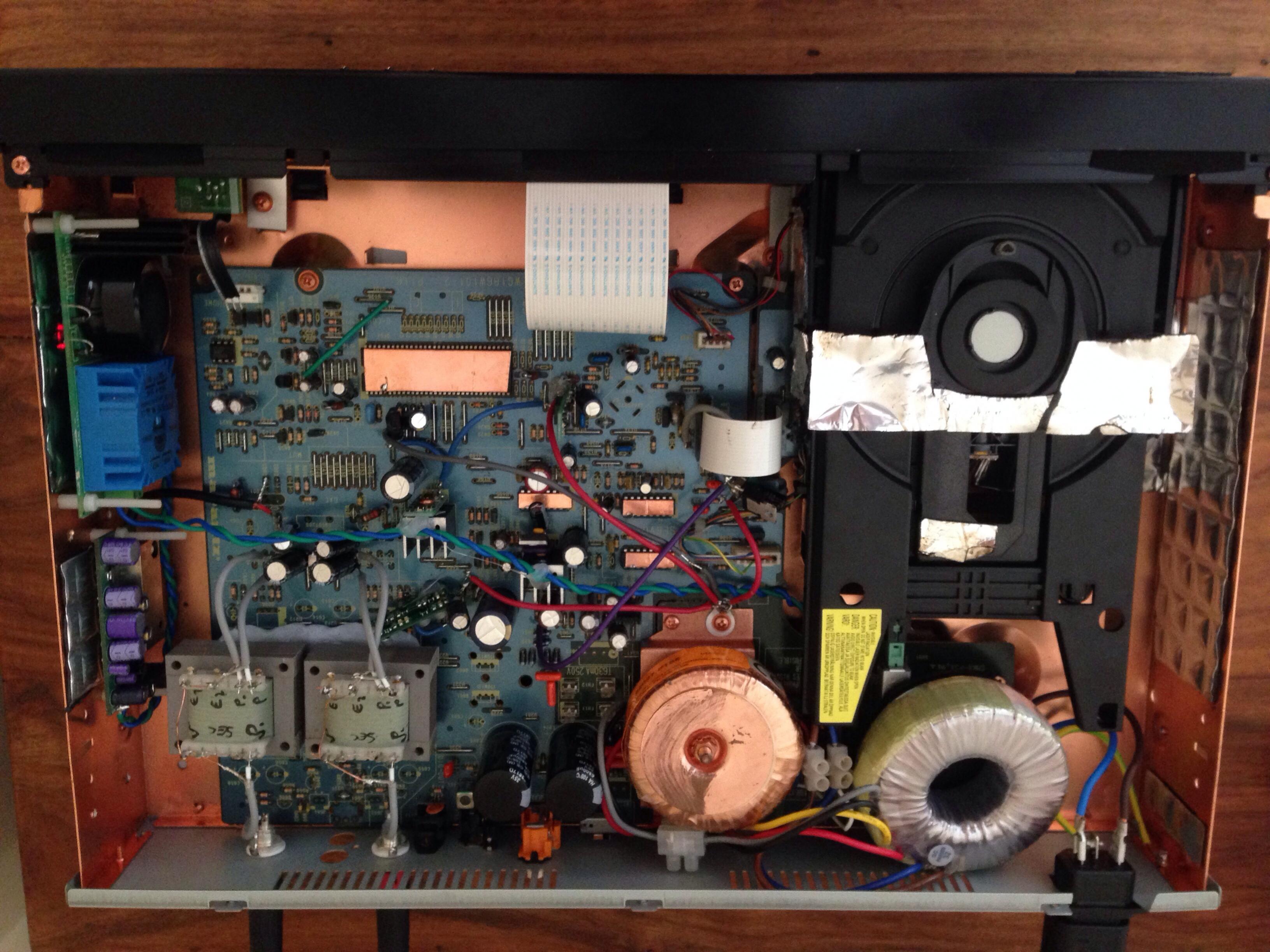

Removed the entire analogue section all the way back to the DAC pins (including the regs and the TX connections). Got separate regs with local bypass caps on the pins and a star ground point. Coax cable for the HF from the servo PCB. Copper shielded all chips and grounded them to the chip pins. Separate 50VA tx for 5V supply, leaving the donated 6000KI tx to power the microprocessor and display only.
These latest mods have cleared up the last drops of noise from the system now. A lot of changes but the results were not huge. I still maintain that for the CD67 Rays original mods list made the biggest improvement in sound quality. Adding a super clock 4S, replacing analogue section with fine silver audio transformers and adding super regs made another step improvement.
Player sounds unreal now. Like the nicest vinyl you've ever heard but without the hiss and pops.
