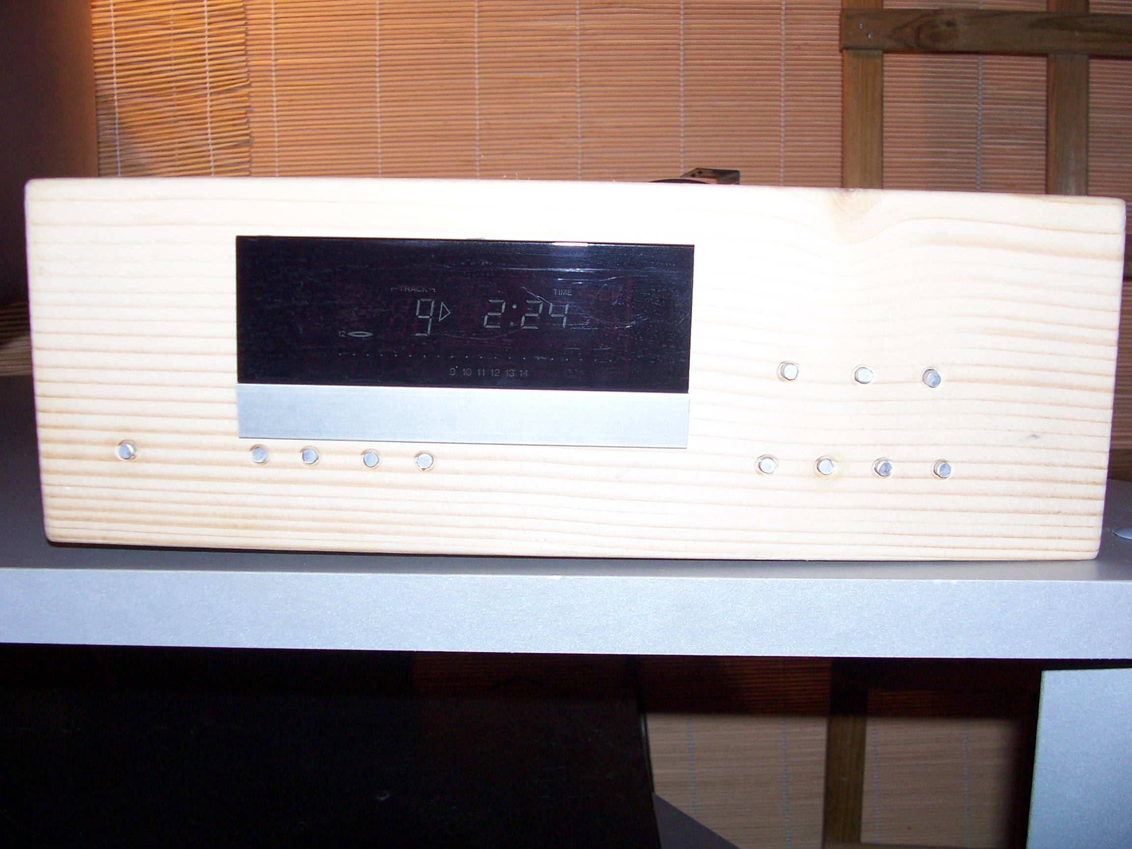

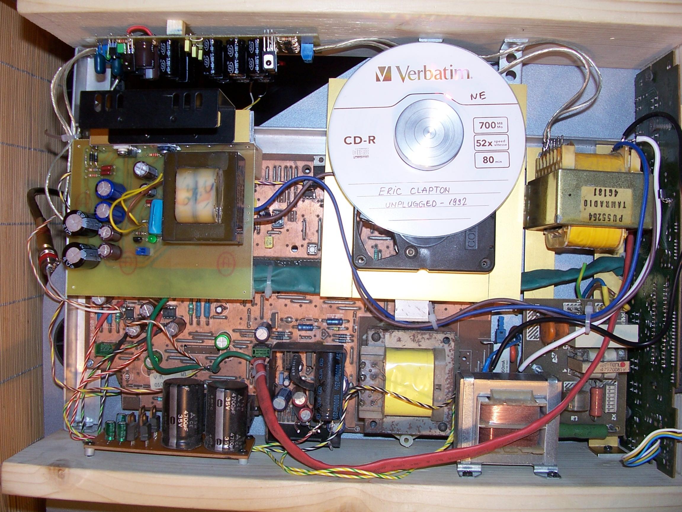

I just want to share some pictures of my CD50 with some modifications based on this thread.
I have to say that the results so far are wonderfull.
For now I made several regulators, one for each voltage supply on each chip, new capacitors, Panasonic on the PS and Nichicon elsewhere. New PS diodes, new opamps and Mundorf caps between the opamps and the new RCA's.
I still have to do the dac's caps and install a new clock.
The regulators where mounted on heatsinks removed from an old PC power supply.
Here are some pics.

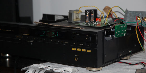

Attached are a pic about my Marantz CD50SE, not finished yet!
All the best to DIYAUDIO community,
Antonio
