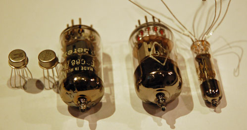

Hi Ricardo:
I have also the LME49720HA. I agree it will sound acceptable, good mids and bass, but the highs are sterile and tiring.
Nothing compares to tubes! Until today I tried as TDA1541 output stage Amperex 6922, 6N2P-EV and 6N16B.
The last ones are the winner!
You can get the transformer needed (180V and 6,3V) at eBay, at Mr. Fikkuz, at Transformatorspecialist, or elsewhere!
If you have any questions please ask!
King regards,
Antonio

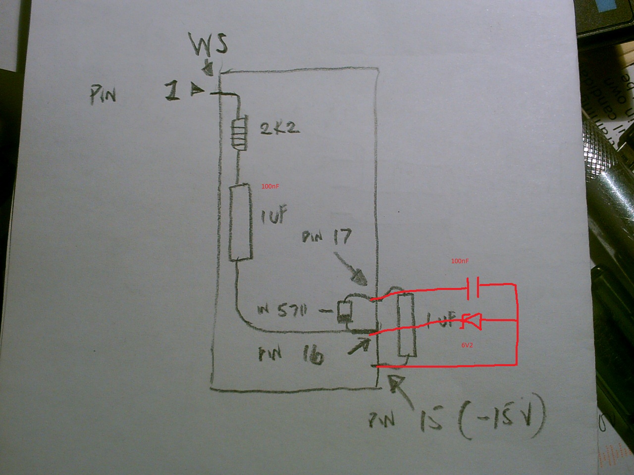

Thanks! Here's what I've got so far:
- Replace all lytic bypass caps (DAC/decoder/filter/Opamps) with 100uF Nichicon FG 25V on analogue rails and with 100uF Nichicon R7 polymer caps on digital rails + replace ceramic caps next to these with 100nF Wima MKS2.
- Replace prereg lytic caps with higher value Nichicon PW
- Postreg caps in PSU: 470uF Nichicon FG
- DC blocking caps: Wima MKS4 4.7uF (though 1uF or 2.2uF would be fine too?)
- Replace 1N4002 diodes with UF4002
- 180pF silver mica for DEM cap
- Replace Opamps
- Regulators: put LM317 (on small veroboard) at +5V power pins of DAC and filter (in place of supply resistor), LM337 at -5V and -15V power pins of DAC. Attach sizable heatsink to LM317 at filter.
- Maybe put in LM7805/7905 at decoder just to get its noise from the main rail?
Any remarks here? I'm especially curious if 100uF is fine for all the bypass caps instead of 470uF.

Well, in my humble opinion you are on the right way!
Here are my comments based on what I have done in some Marantz CD40/50/60 (for me, my brother and my friends):
Replace all lytic bypass caps: ALL of them!
DAC/decoder/filter/ - try 150uf or 220uf (max) - Rubycon ZA (200h of burning time), Sanyo Oscon, Rubycon ZL (of course you know that the best for digital rails is Black Gate NX - the red ones, acts like silk in the sound)!
Opamps: try 470uf Elna black cerafines, Rubycon ZL or Panasonic FC;
Replace prereg lytic caps with higher value: sure!
Postreg caps in PSU: I use 1000uf Nippon KZH
For DC blocking avoid the Wimas and try one of the best bargain in audio caps: Russian MBM Metalized paper capacitors 0,5uf or 1uf (someone told that with Jensen´s you only get around more 5% in sound !!!) - I have that capacitors in all my CD players, and it sounds like no capacitor!
Replace 1N4002 diodes with UF4002: if you are able to get BYV1100 1A 100V 10ns, try that super fast diodes!
180pF (120pf) silver mica for DEM cap: instead try the DEM mod in the pic attached;
Replace Opamps for tubes 6N2P-EV - if not try the good ones like LME49720HA;
Put LM7805 (or LM317T) at decoder, and in all other chips who runs at 5VDC
And my last advice: do the mods step by step to avoid errors and lethal damages in this great CD player.
Luck and go ahead!

Thanks for the great tips! I'm also thinking of replacing the ceramic bypass caps with SMD ceramic caps (X7R, 100nF) closer to the chips, though I may just start with through-hole ceramic caps, don't want to risk frying the chips.
I might stick with 100uF for most lytic bypass caps since the price difference is pretty big (€0.30 per 100uF vs €0.60 for 220uF). I'll make an exception for the postreg caps in the PSU. Unfortunately the only options for audio grade caps at Mouser are Nichicon Muse and Elna Silmic II but from what I've read Nichicon FG seems like the best choice for my taste anyway.
Any low-priced alternatives for the DC blocking caps? I should probably just get rid of them, my amp has DC blocking at the inputs anyway.
That DEM mod looks interesting, I'll give it a try!
