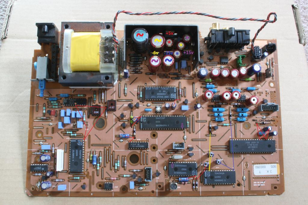

I'm wondering about the attached pic posted in the thread, what Marantz CD is it ?
The PCB looks very close to my faulty CD873, Hedphone section not implemented (connectors/AOP).
I'm convinced it's the same PCB, except the fact that some options aren't plugged/populated.
Marantz CD873 is a "Midi' size player : CDM4/11 - TDA1541 - SAA7220...
I've to fix a tray trouble but can't find the Service manual for the board.
Player works fine but refuses to eject the CD when pushed.
Thank for your help 😉

Thanks.
There are pics posted of Marantz CD-50, CD-60 and CD75dx. Some pics can't be seen now since I've exceeded the photobucket bandwith it seems.
The pic you attached looks like a mix between cd-50 and cd-75dx.

It seems that the board is the CD74x.
Do you have the Service Manual or a link to download it ?
Anwerring to myself : http://fileshare.eshop.bg/ 😉 😉 😉
But no SM for CD74x... 🙁

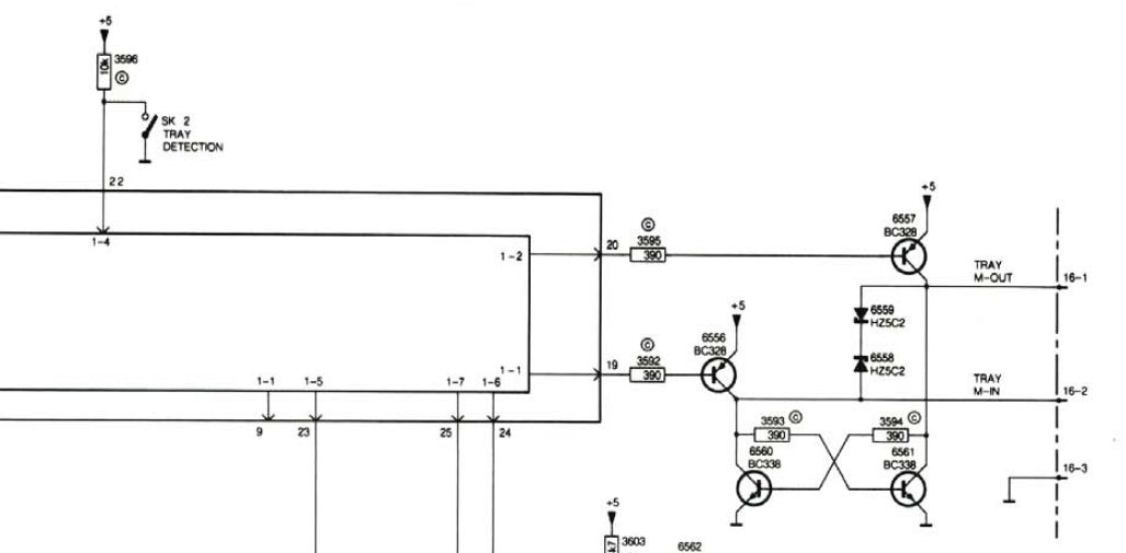

The CD873 is fully functional except open tray operation.
"Eject button" has no effect, I have to open the tray to change the CD...
Motor try to eject the tray but stops and stay where it is, no more action.
When tray is open, I can move the tray in and out, but carring not to let it go to the end.
If so, the tray reaches the end of the player, the effect is that it can't be opened except manually.
I've checked belt and mechanism, i'ts Ok and works fine.
Any suggestion ?

The motor that drives the tray? Bad cap/caps in the motor PS?
I don't know. Try measure the voltage available for the motor.

The motor that drives the tray works fine, as the belt and puley.
You're right I've to check tray caps in motor PS 😉
It seems that the tray goes wrong when it came inside the mechanism.
When Eject button is pressed, it refuses to operate, it tries but stops immediatly...
Don't worry, I'll find... or not 😀
Voltage on the motor tray : -4.78V going inside & +4.79V moving outside.
I've to care the tray don't go completely inside, otherwise it's locked and I've to it push manually... searching on the 65DX SM some hints.

What are the voltage supposed to be for the motor? If a cap is bad in the PS it might loose power and not be able to completely move the tray?
The oscon sepc are very nice too. But I don't see the benefit of using them here since there'll be a reg between the cap and the digital IC.
I've read the SM and it should be 5.00V, maybe 4.78V is a too low value.

Doubt that would be too low on its own. Don't remember if you had cleaned and lubricated the sled(where it should be greased, and only use very little).
I'd check caps and also maybe clean what looks to be switches in the Schematic you posted.
