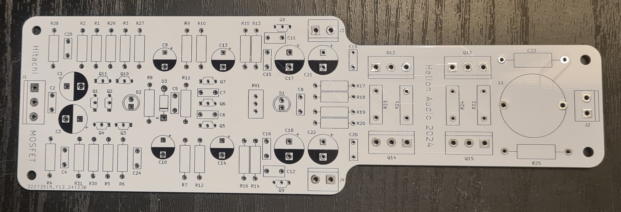

Note that the graphics for the MOSFETS are screw terminals, NOT transistor packages wrongly placed. Confusion avoided, I hope...

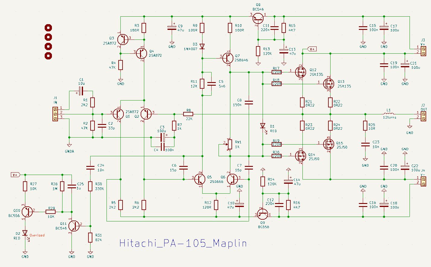

Hi Nigel, any chance of getting the gerbers for this design and the schematic you used. I assume you built and verified it?Heres a pcb I designed to replace Maplin one.
Added extra decoupling and added voltage offset pot.
Gary.
