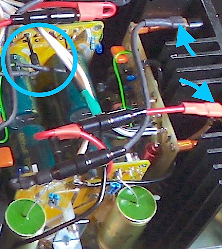

Re. the Schottky diodes, I'm not talking about the main PSU 🙂
What I did was cut the traces between the output mosfet drains and the PSU on the PCB.
So the main PSU power goes, via inline fuses, to the output follower MOSFET drains. Dirty power there doesn't worry me so much, so PSU sag will and does occur there.
But the driver stage, home of the control loop and small signals, is powered via schottky diodes (for low Vfwd voltage drop, and to prevent back-feeding the MOSFETs), and 39R (IIRC) resistors to soften the recharge of the on PCB rail caps. I'll lose < 1V doing this, but the control section power rails no longer dance withe the music so much.
On my monoblock version of these boards, I also cut the tracks, but used a seperate bridge and caps for the driver section, which is better still. But that one hasn't got the CCS mod etc, so it's not all perfect 🙂
Of course it really needed new PCBs, so I could lay it out properly, but budget and time meant a small bodge with the heatshrink instead LOL. Also if I made a new PCB, I'd want a tightly regulated supply of about +60V on the driver board, with perhaps some studying of the ground current path. Then I'd get 'feature creep' and end up with a new amplifier - haha. 😀
