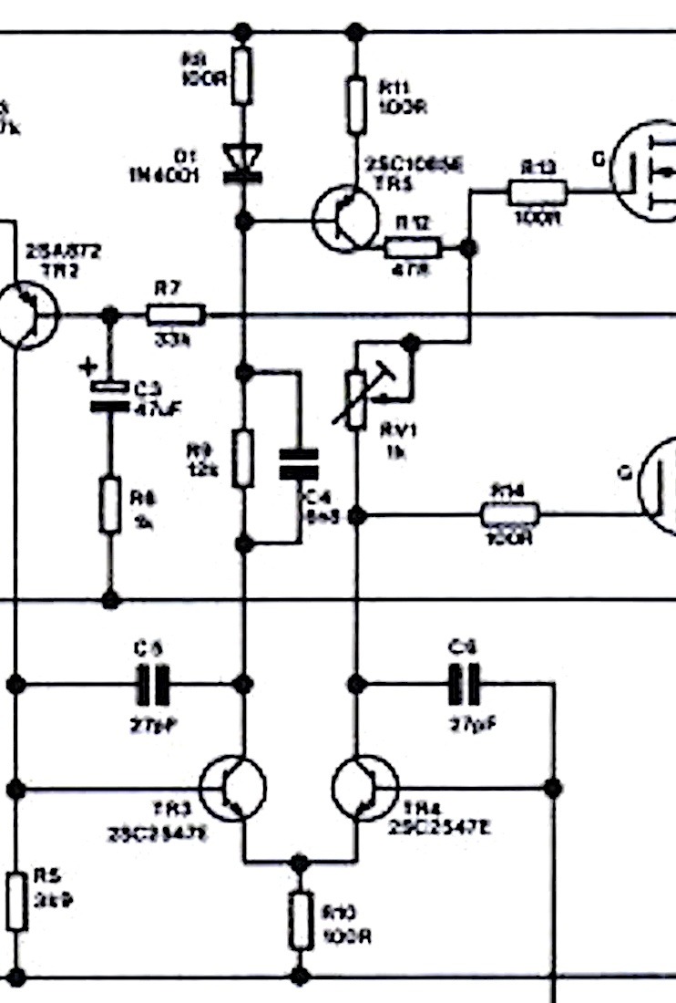

But I'm baffled about the original 6n8 C4, that goes in parallel with R9, in the original Maplin schematic - do you know what that one does?
I ended up deleting it in my schematic above, as I found it just sucked current on clipping - fighting with the current source. Perhaps when not clipping it does something - but what?

I expect C4, 6n8, across R9 is to speed up the current mirror in the original circuit. I think the whole high frequency compensation scheme is a bit messed up, with different impedances around TR3 and TR4, so what looks symmetrical cannot be symmetrical. It works with just the 27p cap around TR4.

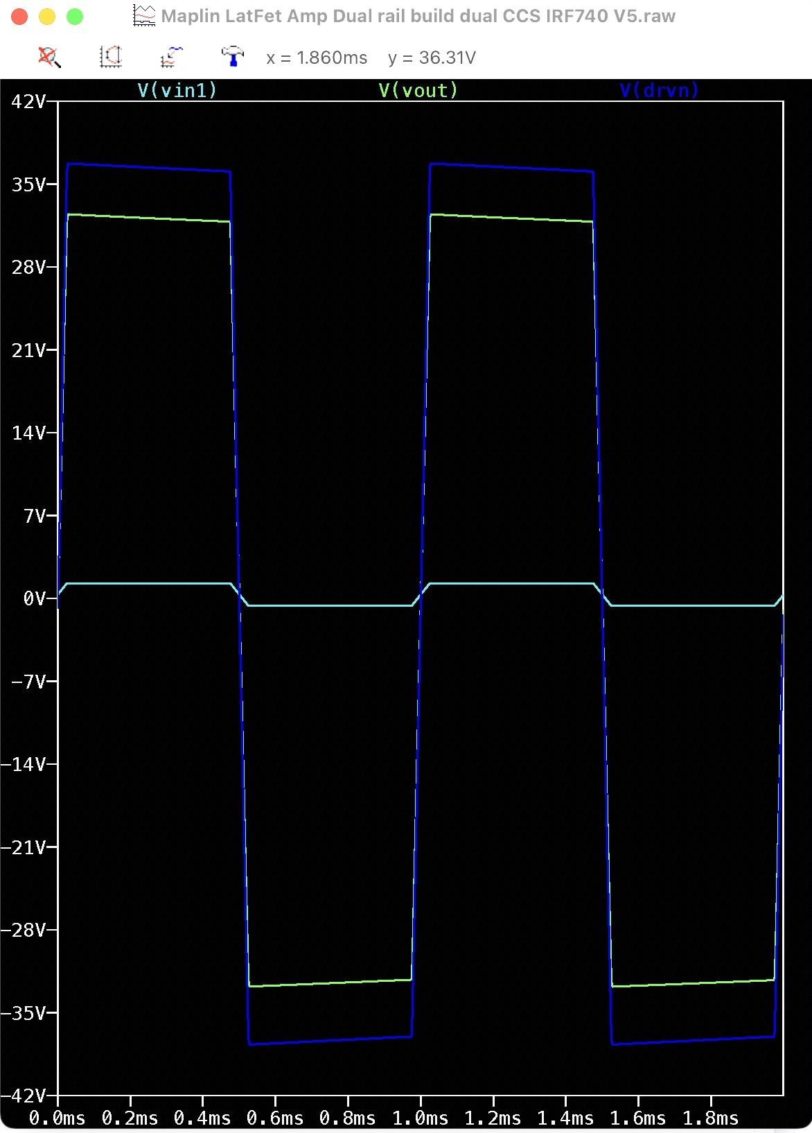

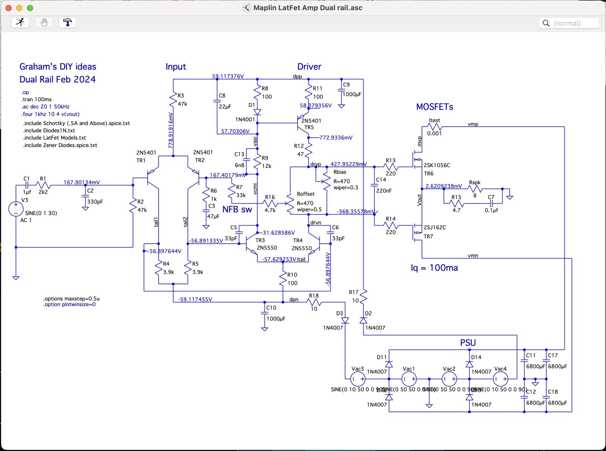

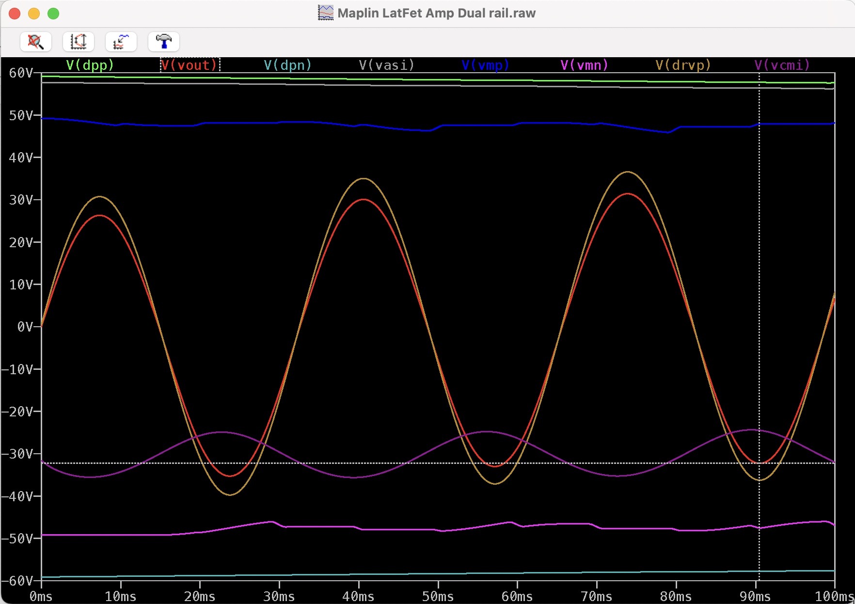

Hi all, some more testing with the Maplin PCB - this time on dual power rails, 10V more for the driver, and switcheable feedback. Yes, finally got the offset dialled out!
So most is standard Maplin, for least modding. Note the 6 x 1N4001 used in the PSU are just for simulation!!
The simulation voltage sources, all 4 of them, start with a 90 degree phase. This makes the DC .op work, so I can see the settled voltages on the schematic. If you change all those to 0 degrees, you see the voltage ramp up as the PSU starts. Some internal resistance in included in the PSU voltages.
The feedback switch is where it says NFB sw. Add a little switch in there to select the speaker out (usual GNFB) source, or with an additional 4.7k to select the Roffset. This gives identical levels into 8 ohm - the 4.7k nulls out the extra voltage the NFB sees from the driver.
As you can see, even without feedback on the speaker, the MOSFETs follow faithfully, no sweat.

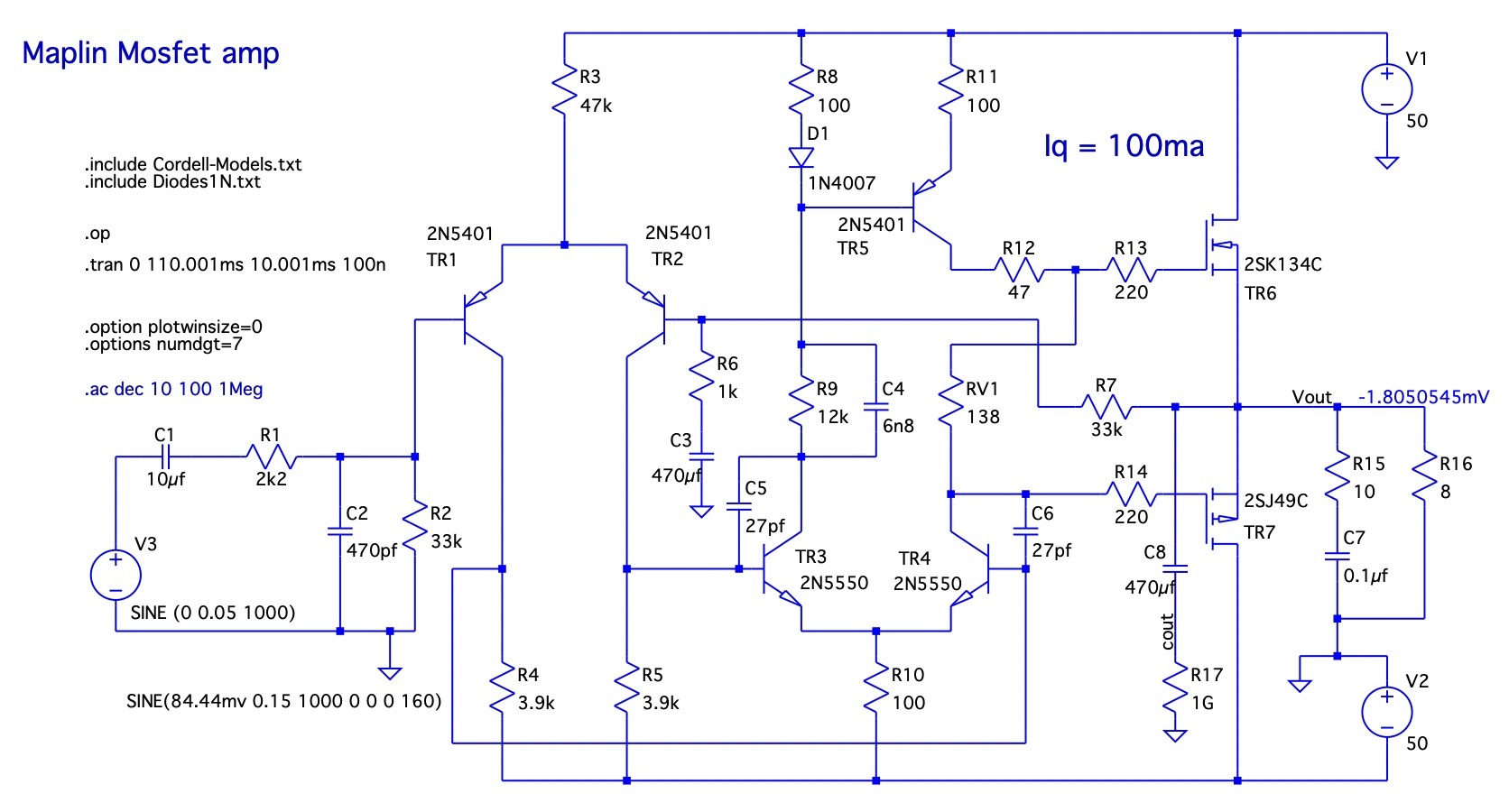

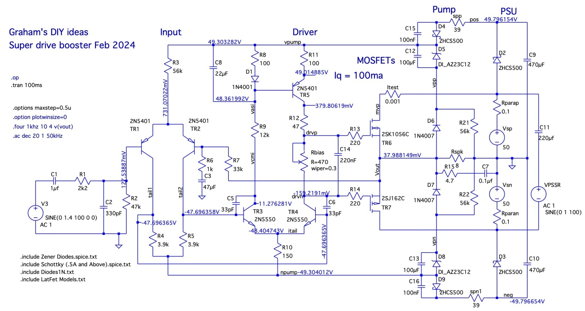

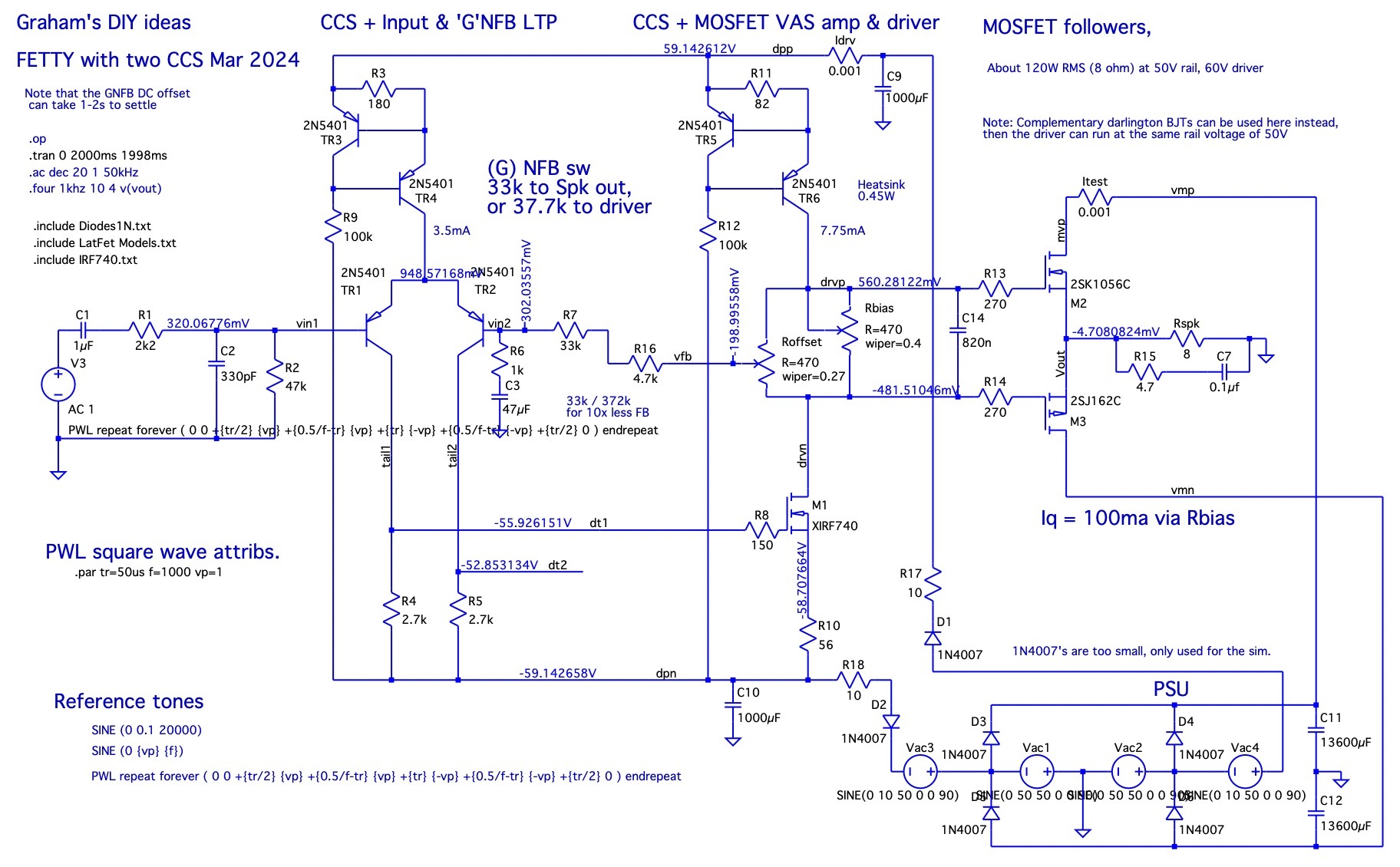

Hi all!
In my gradual narrowing of 'how far to mod the Maplin', vs 'understanding how the old Maplin driver section actually worked', vs 'what about if I' mods, I've been investigating a little more.
I'm not really much further forward, although I did buy some 2n5401 and 2n5551 transistors as they are cheap and available here in the UK.

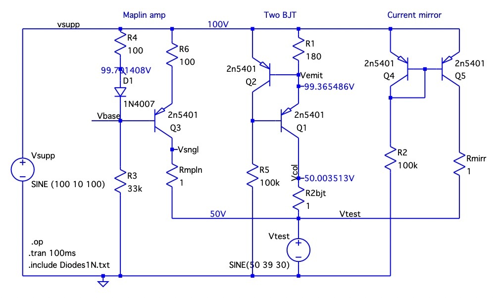

I investigated the current sources in a simulation of how constant they are in the face of a wildly varying voltage, and settled on the two BJT transistor one as my favourite.
I then realised that TR3 in the Maplin, was really acting more as a follower in this, to drive the emitter of TR4, the base of which was driven by the other side of the input TR1/2 LTP.
So in the Maplin TR4 is the main VAS, and it's current source TR5 wasn't 'that' great.
So I thought what would happen if I got rid of the follower TR3, changed TR4 for a nice MOSFET (couldn't find a 150V FET) and added another CCS to the input LTP at TR1/2.
So to me this looks like a nice clean design. The key is that the audio only has 2-3 devices in the NFB loop, so they are very fast. The CCS are 'sort of' in the path, but working to stay 'out' of the path, so any fast HV pnp will do.
Not sure what the original dissipation of the TR4 + TR5 on the board are, but suspect they run quite warm.
So how much to mod into the Maplin, I'n not sure, the CCS may be a fairly easy implant, but maybe for the ultimate I'll have to consider new PCBs.. and a new project.
Anyway, as usual, please comment and I hope the mods are interesting 🙂

Globulator:

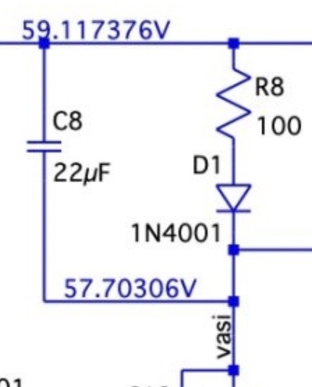

I am curious why you have C8 in the current mirror circuit circuit of the amp.
Doesn't the presence of that cap severely impede the performance of the current mirror at AC?

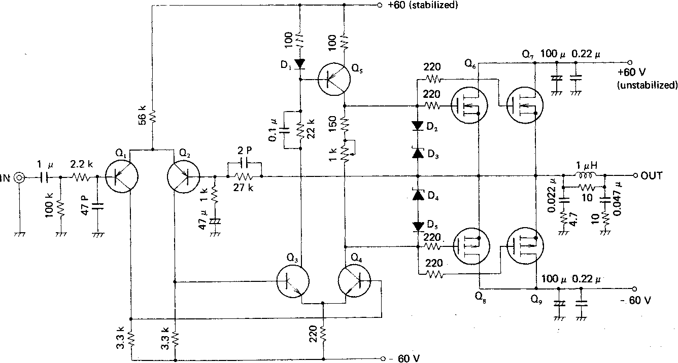

At the risk of dating myself as a fossil, I'll say I first saw this topology applied to an amplifier with a MOSFET output stage in this article while in college in the 1970s: "100 Watt Super Audio Amplifier Using New MOS Devices" from IEEE Transactions on Consumer Electronics (a professional journal from 1977).
This is the schematic they featured from that long ago article. Very familiar as you can see. Hitachi engineers wrote this as they were releasing the ubiquitous lateral MOSFETs.
If I find my copy of the article, I'll post relevant pieces, unless you find it first.

Hi!mirror
Haha, we're not fossils, I'm sure we are hydrocarbons LOL. 😀
Interesting schematic!
C8 in post #247 ? See attachment #1.
I found it tightened up the performance of square wave and clipping, in the simulation.
Without C8 the voltage at 'vasi' has pretty constant anyway, C8 making it 'more constant' helped what I saw at the output.
Later I realised that this path is not really a CCS at all (it's a 100R resistor and a diode), but that TR3 is acting as a follower, well, that's my conclusion LOL, and it was really not much of a mirror.. (see attachment #2). That 12k with the 6n8 bypass - what's that?!
So in a way C8 is connected to the reason I removed TR3 entirely on my latest mod above, and TR4 which was doing the donkey work in the VAS (is it really a MOSFET amplifier if the voltage amplification is a BJT? - discuss), I felt was not as linear as a MOSFET.
The absolute linearity of the MOSFET is less IIRC, than a FET, so for a lower voltage amp I'd use a FET there, so the voltage is amplified as sweetly as possible, tube-ily, and then the NFB has a more linear system to play with.

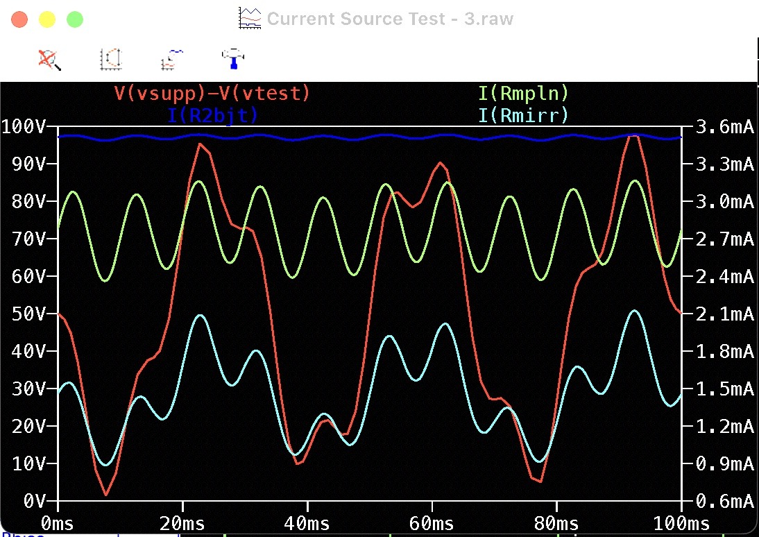

This is my little current source 'test jig' for the curious 🙂
The almost invisible blue trace is the 2 BJT case in the middle, the maplin (mpln) one on the left, and I've seen a number of people using the mirror, on the right.
In this test the supply rail is bouncing as is the test voltage, so reference and source are moving.

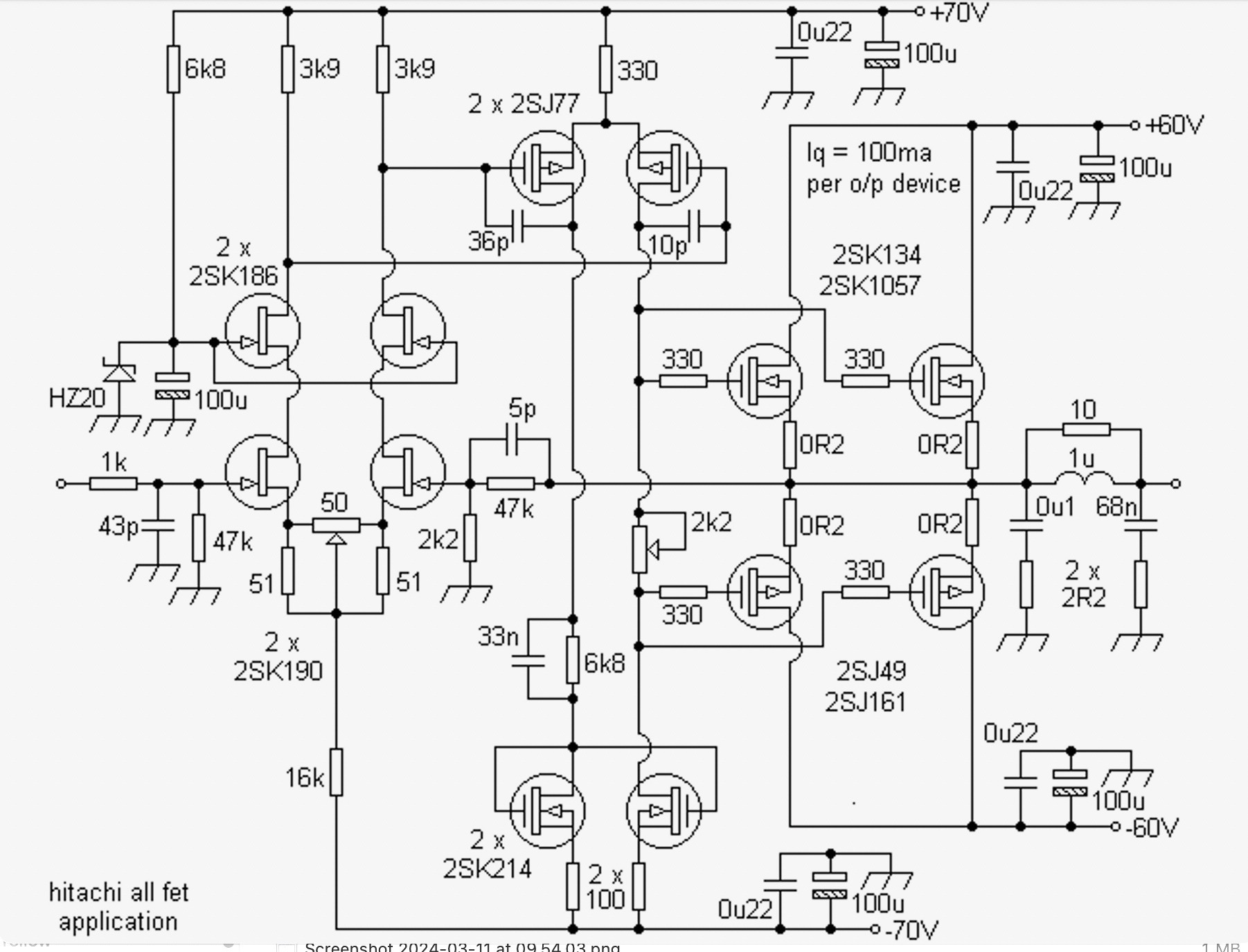

The Maplin MOSFET amplifier is based upon the one given in the Hitachi application note for their MOSFETs, and it is nearly identical to the Hitachi design.
In the application note, there is an All-FET amplifier, without any bi-polar transistors.
A search could uncover the original, which might be a useful reference.
Good idea!Hitachi application note
I found one, this is where the Maplin kit came from 🙂
Looks the same except for no resistor in L1.
I'll also have to actually read the note, as there could be useful tips there.
I also found the Hafler DH200 schematic (and construction notes), it's a BJT driver of nicely symmetrical LTPs, followers and (IMO) dubious current sources, but still interesting to see another way of driving them..
Ah - here is the motherlode 😀All-FET amplifier
https://www.angelfire.com/sd/paulkemble/sound7g.html
That's a different App. Note to the one I have.
A different take on it can only be good.
Not sure if the All MOS amp is the same one, Iit would take me some serious searching to find it.

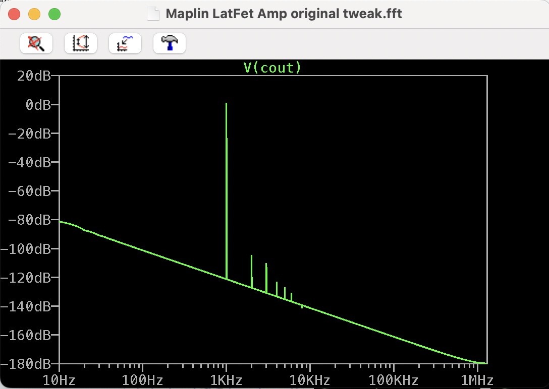

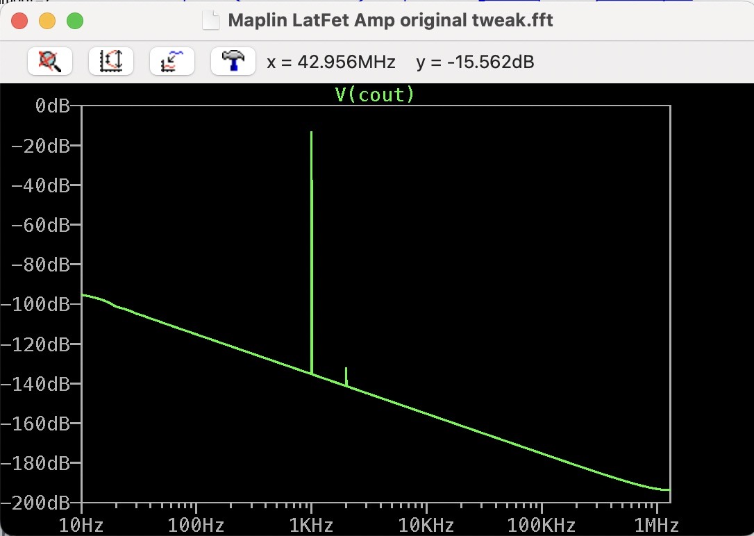

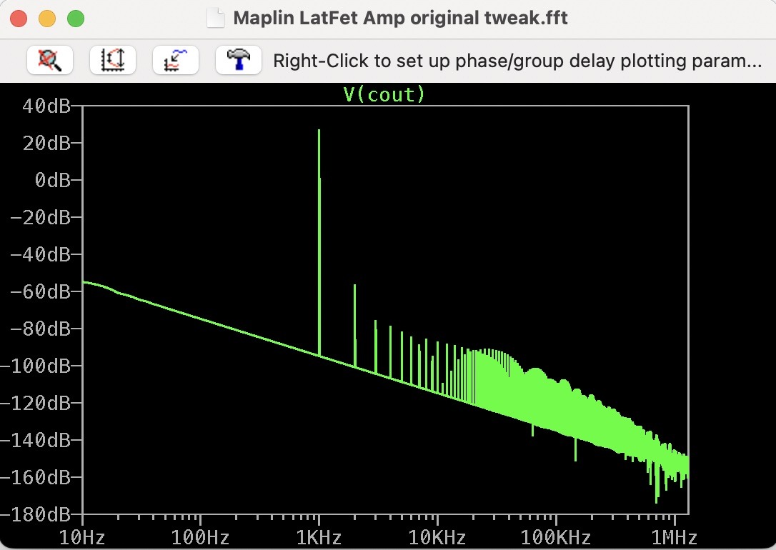

Hi all, I thought this may be of interest.
I'm learning about the FFT feature - it's on the LTspice waveform graph as 'View->FFT', done with 262144 points and 1 point smoothing. Not sure what tilts it, some time delay perhaps.
So I thought I'd look at the original driver circuit before claiming any 'improvements' 😀
FFTs are for 0.01V, 0.05V, 0.1V and 1V input.
The reason this design sounds so nice is clear to see - quiet, before the current drops off from any MOSFET, the overall performance is indeed, stunning.
Up to about 1Watt, depending upon the biasing, it's remarkably clean.
Above that the current falls off the idle MOSFET and the GNFB has a mad scramble, thus pushing all of the harmonics up the frequency scale - but still quite low. The GNFB loop is quite short, IMO the reason it works well here.
Then at 1V input, 30V output it's a big fuzzier but still pretty clean.
I.e. distortion rises with level which is natural, and at the most popular listening levels, <1W, it's only a tiny bit of 2nd, so very sweet.
I suspect the higher the bias, the cleaner the sound as it does seem to be the crossover into class B that brings it out of the sweet spot - so perhaps much of the quality is simply down to a very very clean class A region with a graceful degredation into class B, more subtle with for BJTs.
Firstly are you using an FFT window? Usually essential unless your signal exactly repeats in the duration of the run (which is always going to help anyway). The flattop window will give accurate peak heights, note, other windows can give a dB or two of error due to scalloping.I'm learning about the FFT feature - it's on the LTspice waveform graph as 'View->FFT', done with 262144 points and 1 point smoothing. Not sure what tilts it, some time delay perhaps.
There are some options for more accuracy in internal calculations that help FFT's come out better:
.options plotwinsize=0
.options numdgt=10
Often it pays off to hide the first bit of the simulation from the output in case there's a start-up transient which will add low-frequency energy. So for instance
.tran 0 11ms 1ms 2e-8
(which samples from 1ms to 11ms, giving a run of 10ms with any issues of startup transients chopped off the front.)
