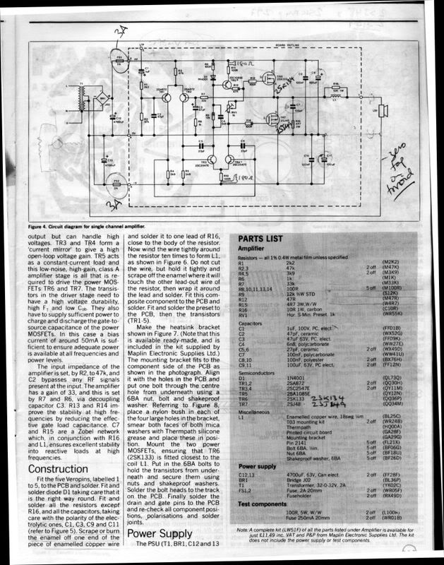

I have used the Maplin original circuit except for 390R gate resistors and ALF16N16W and ALF16P16W lateral mosfets. I also decoupled the power rails to the LTP and current mirror stages.
I have started planning a second version.
This will have a constant current source instead of the 47K resistor on the first LTP.
I have removed the diode in the current mirror and used a transistor instead.

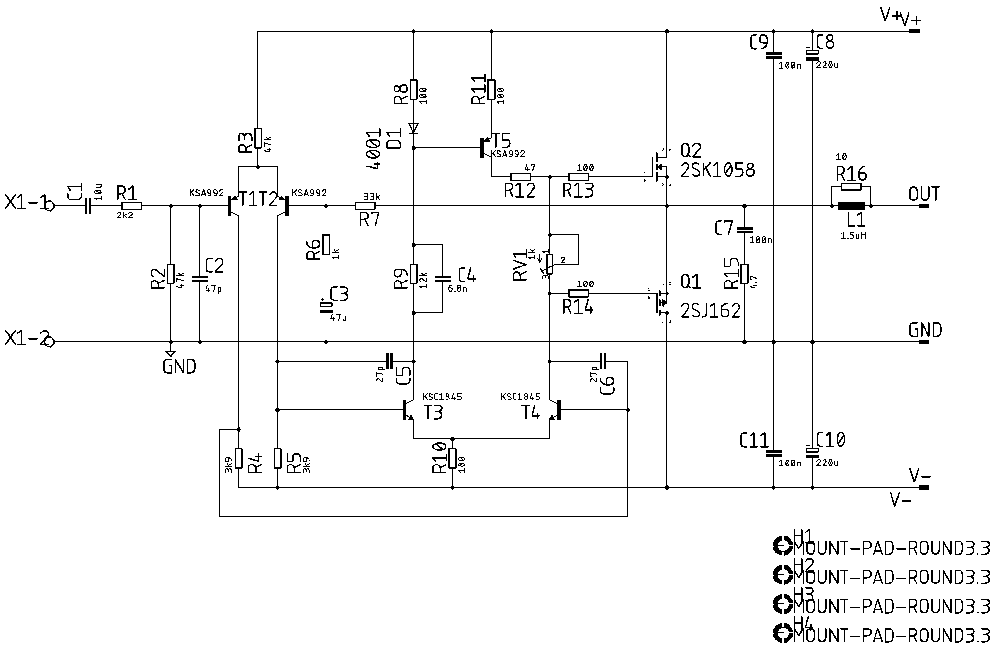

Here is cct diagram of second version.

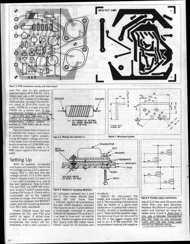

The tech specs (third page) shows how to add paralleled transistors to output stage to increase the output power. Don't know if anyone actually developed this into a new product. I think your re-vamp with a sprinkle of Self and Cordell circuit up-dates will produce a nice sounding amp module.

You could use the circuit here replacing the output lateral mosfet.s
http://www.ckp-railways.talktalk.net/maplinlateralmosfet_2.jpg
EBB 250 mosfet amplifier module schematic

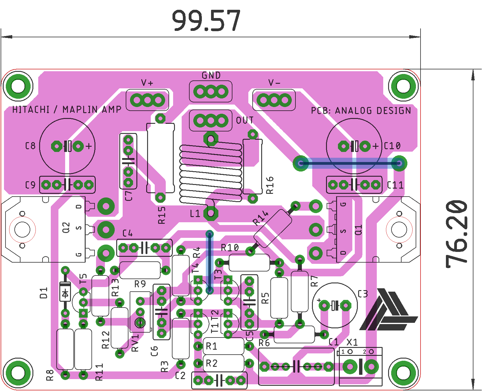

here is final ver of layout posted here for this amp.
