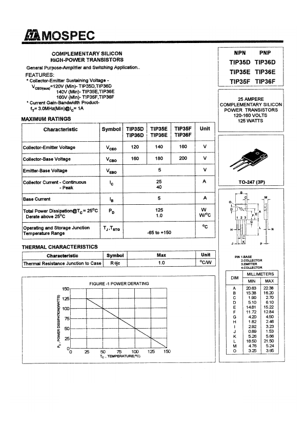

As a replacement of 2n3055; tip35c a very good option if you can mount them inside nicely with good heatsinking. But not more than 35-40volt/rail. I think you know this already. Don't know about high power to-3.
SOA on TIP35C isn’t wonderful - falls off really fast above 35 volts. And don’t push it either - they mean it. Grrrrreat for small-ish class H amps where they never see too much VCE while supplying current, but a NO NO for +/-50V class AB. Even two in parallel. if that D, E, and F aren‘t any better above 35V who cares if the VCEO is 160? But if they are REALLY the dies out of the old 2N5629, 30, and 31, THEN we might be getting somewhere. The s/b breakpoint on those is 35V too (according to the spec sheet), but it doesn’t fall as fast and they can really take more than their ratings.
A friend from latin america once told me that Mospec Tip 35D was very robust. He used +/-50v rails to drive 8ohm load.
Yes that's correct. One has to be very selective for BJT devices regarding SOA as it plays a very important role else the device will go into secondary breakdown. Thats why MOSFET are preferred as it do not suffer from secondary breakdown and drive is simple and very straight forward.SOA on TIP35C isn’t wonderful - falls off really fast above 35 volts.
