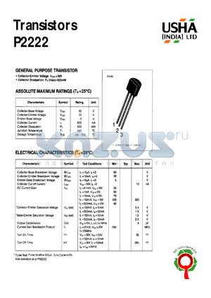

Where are Usha transistors available?
Please post details.

Usha appliances (company name Usha (India) Ltd.), has merged Usha Rectifier with itself. The device company started in 1964.
They were last doing device packaging on contract for Samsung and Fairchild, but there are no submissions since 2005 with the Registrar of Companies, which is mandatory.
Usha (India) also seems to have two similar companies, one is Usha Rectifier Pvt. Ltd., set up in 2015, and Usha International.
They make and trade in ceiling fans, sewing machines, and so on, but their site does not mention the semiconductor business, which was merged with this business.
The private company, Usha Rectifier Pvt. Ltd., in turn owns a software business...and the owners are unrelated to the original promoters.
The Usha family was originally one of the owners of DCM, a giant of its day, family disputes and labor problems ended it.
And in the field also, it seems defunct for the electronics side..

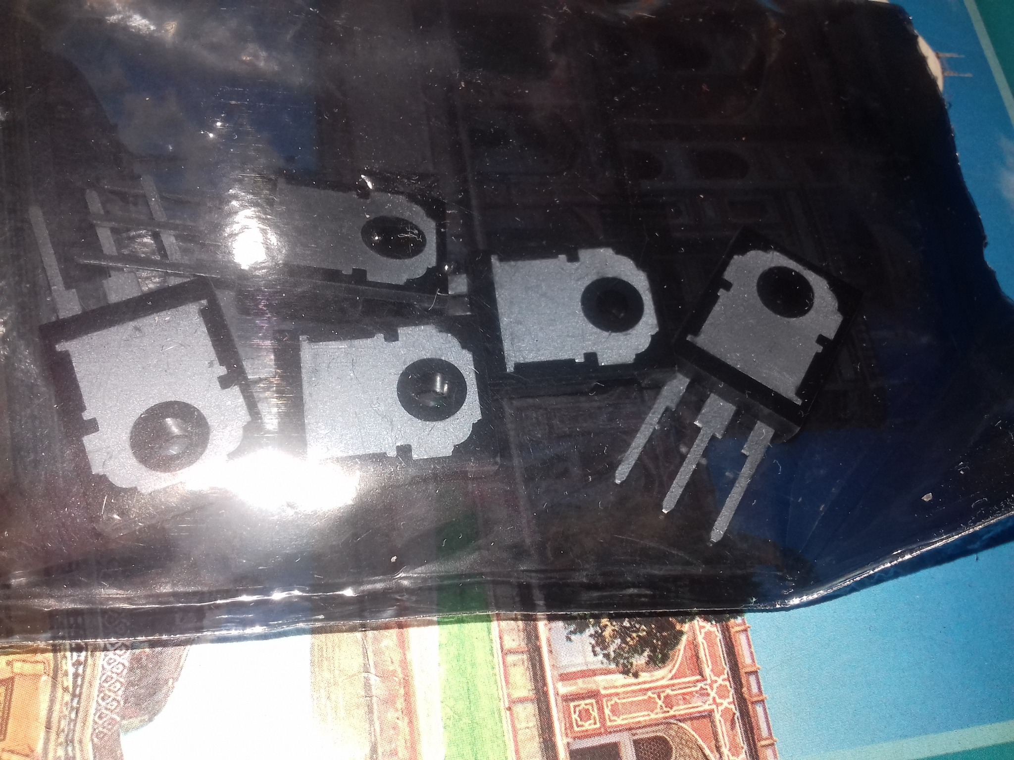

@wg_ski Yes 🙂 .... the price of Onsemi is little higher but i think ST is fine for the Job. I don't need more than 8watt into 8R from JLH. I'll use 4mm thick 0.5in wide alu bar to sandwich those TlPs with the heatsink
(200×100×40mm each). I believe i don't need to3 here. I'll use same transistors for PSU also.
@JMFahey Thnks. Here in india i never heard about USHA 3055. But many years ago you posted about this (you posted couple of pictures of TDK plant etc); Yes, i did read the thread; i remember
