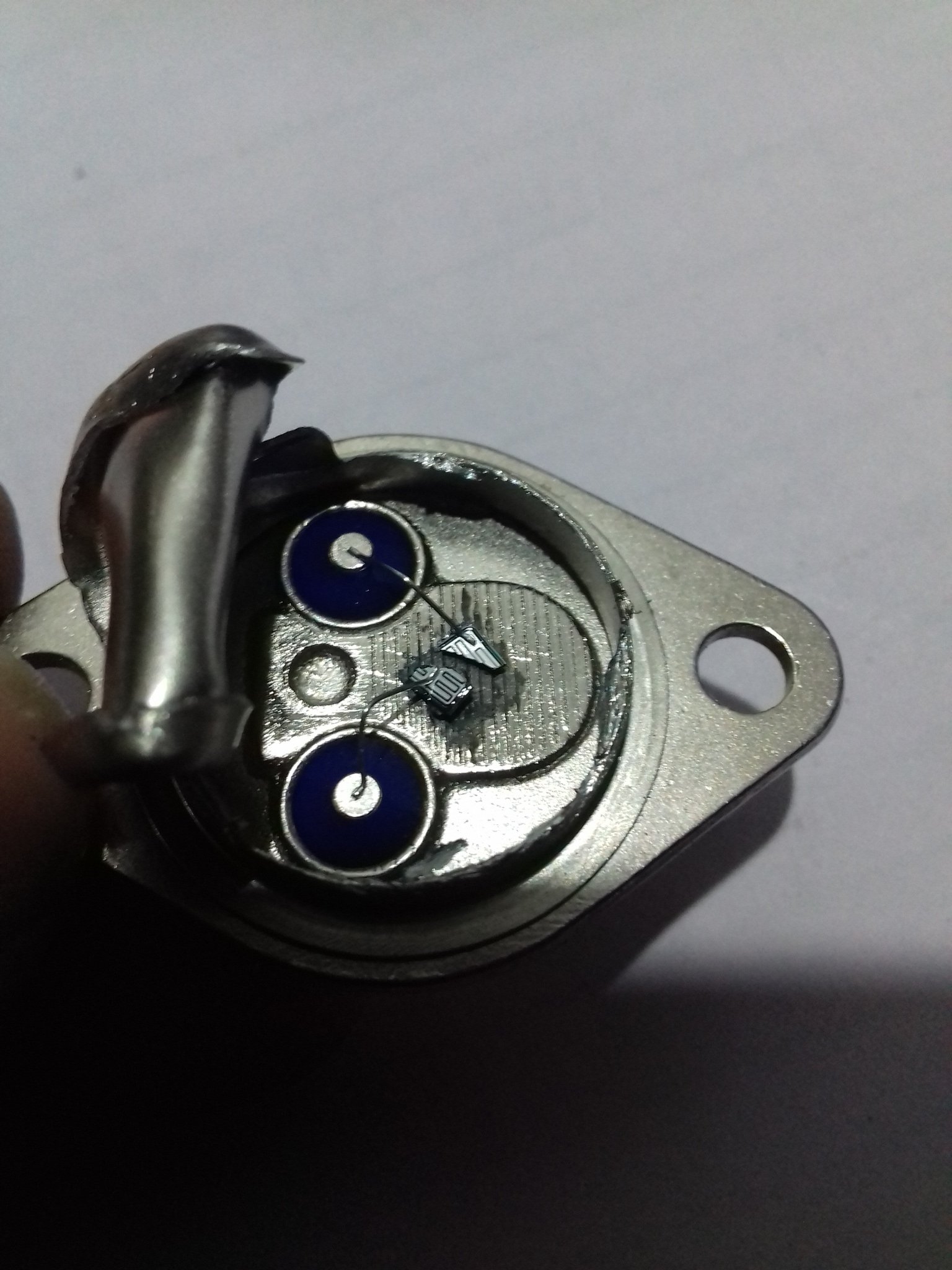

That die looks too small to be a 2N3055 with 15A collector current rating.Now tell me what do you think? Look at the die, it was already broken. But size of the die looks good, at least to me.

Yes, at first i set the range at 10A then 200ma. Anyway, this is the result of the test~
1st transistor--------
60-80-100ma...increasing(base open)
Same reading(1k between B to E)
2nd transistor--------
70ma (base open)
35ma (1k between B to E)

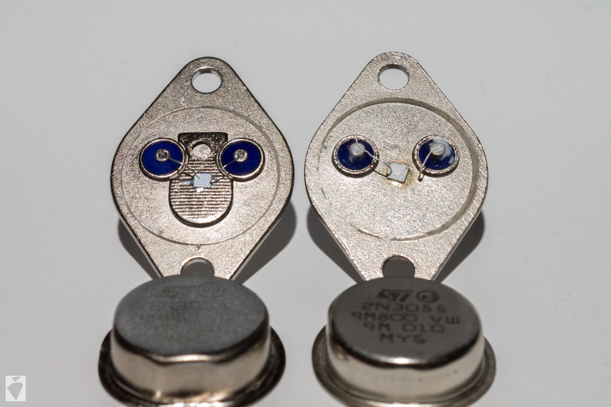

Absolutely no doubt, they are leaking like a sieve. Those are faulty beyond belief for supposed new parts. Fakes, damaged, rejects...... they need to go back for replacement.

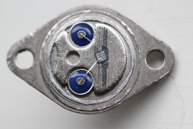

They are certainly a lot smaller than genuine 2N3055s that I have opened in the past, perhaps 1/4 the area.
I'll not use any of those(all six tr) & going to place a new order at RS comp. Preferably to-3p package. Anyway thnks to everyone.

RCA 2n3055 had bigger die. Much bigger than modern 3055.They are certainly a lot smaller than genuine 2N3055s that I have opened in the past, perhaps 1/4 the area.

BOTH are fake.
The left one is identical (so probably same "OEM" maker/faker as that sold as "Toshiba" .
The red labelled "Toshiba" in general are "good fakes", they stand even more voltage than genuine ST 2N3055, anything from 80V to incredible 114V, what makes me think they are relabelled TV vertical transistors or similar, they also have the small but barely adequate "8" shaped copper heat spreader.
When nothing better is available, I use those to repair my own old Guitar amplifiers (I have delivered over 14000 of them and keep them running forever, if Customer wants to) so I still need a stable supply of metallic TO3 2N3055 or equivalent.
Now the one on the right isn gross: small die but much worse, NO heat spreader .... a suicide waiting to happen.
Even IF they met Electrical specs, they will never survive, except, say, a Home use 30-40 W per channel amp which is putting out average 5W RMS or so.
Another telltale sign is that some of the worst fakes use a VERY thick base, think 2mm or so, in a futile attempt to dissipate a little more.
And quite likely made by CDIL, or another source, branded as ST, legally done of course.
