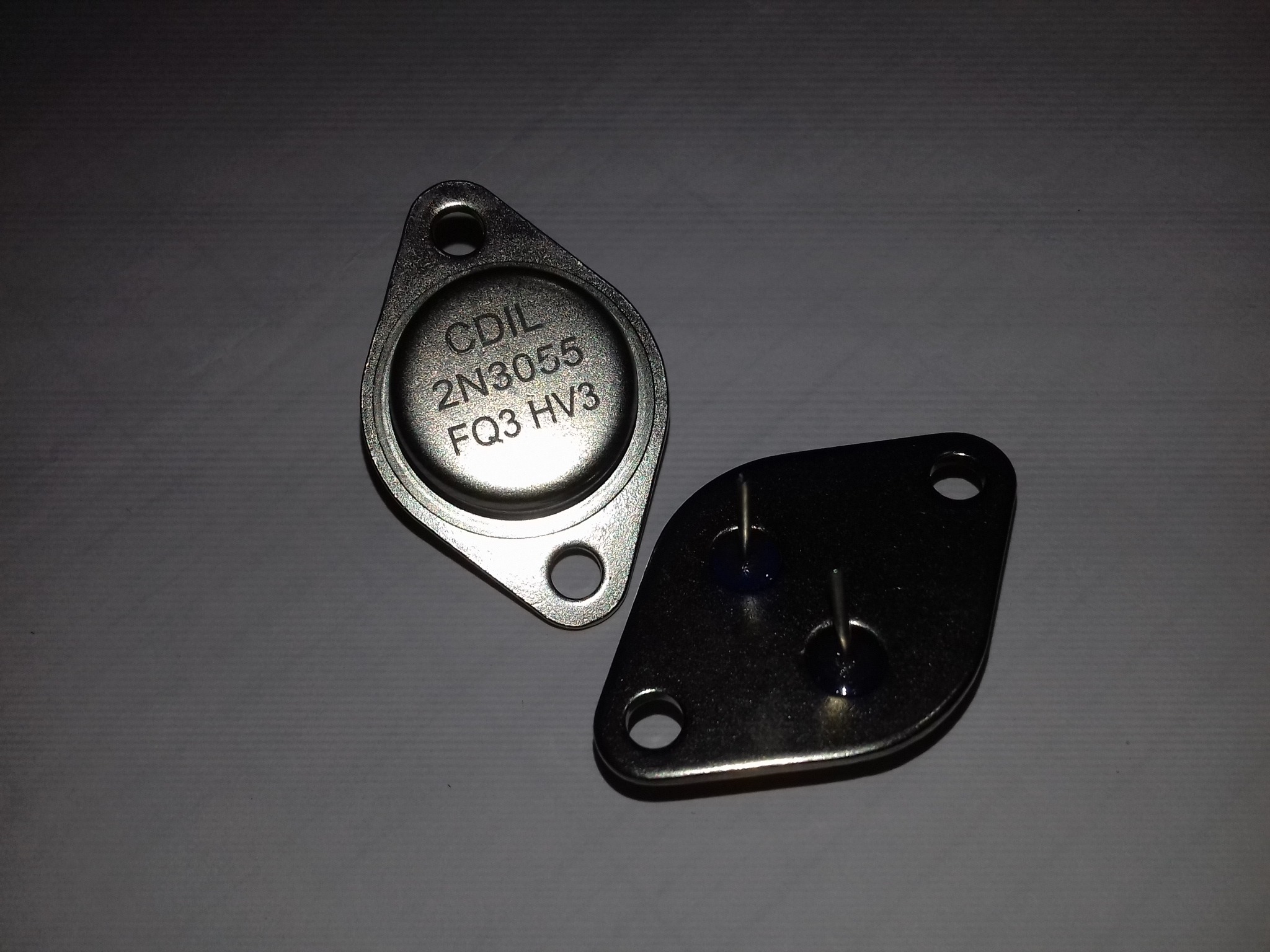

Fake CDIL 2n3055?! I never said that. This transistors are genuine, has manufacturing fault i believe.@nirupambhowmick, Please post pictures of fake CDIL for the benefit of boarders.
No this is Genuine for sure. There must be a manufacturing fault. You should contact CDIL management through email for such a fault. I think the Management will be prompt to address the issue as this issue is linked to their reputation.Fake CDIL 2n3055?! I never said that. This transistors are genuine, has manufacturing fault i believe.
Why blindly blame CDIL? diyaudiocart may be a reputable store, but I am sure there is no guarantee that whatever they sell is A1 and genuine! Amazon is supposed to be a much more reputable seller with international fame, but their online store is full of fakes, duplicates and unreliable products.Very recently i purchased 6 CDIL 2n3055 transistors from a reputable indian online store (diyaudiocart). After receiving i took a multimeter/diode test & believe me among 6 transistors three is faulty. All new & genuine 3055. So as per my experience beware of second source like CDIL. Always buy world class transistors like from Onsemi, St & Toshiba.
I have used hundreds of CDIL devices (I'm a manufacturer of audio, Hi-Fi and PA equipment) without much problem. I think the source of your problem is the seller. You should have tried to return the transistors immediately to the seller (in case they have a return policy for semiconductors). If you have approach to a local electronics market, then try to buy from them since you can get a choice, and moreover, I have found out that shopkeepers actually declare a product as duplicate or genuine before selling. This is my experience in Delhi's Lajpatrai market. Hope that helps. 👍

Don't forget diyaudiocart not only sells electronic components but the 'one & only' online hi-end spkr driver seller of india. In the past i purchased several 20x more expensive transistor pairs from them, not a single failure. Btw no one buys audio grade electronic components from AMAZON except some cheap class-d amps & cheap quality resistors/capacitors.Why blindly blame CDIL?.....

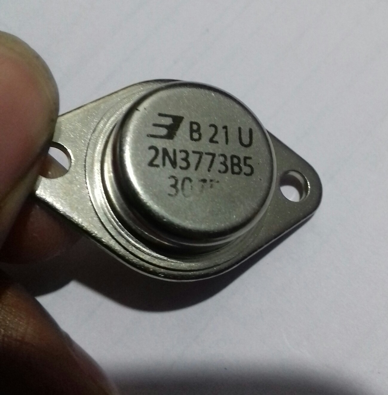

On the other hand i'm not blindly saying this...i already did some tests. This is what happens when you rub aceton/ thinner on Fake transistors(see attached photo). CDIL 2N3055 passed this test. I already said that it seems a manufacturing fault so their quality control is poor or someone from CDIL factory selling this defective transistors to open market/vendors.

Your image seems to have BEL image ,
2n3773 or 2n3055 if needed , BEL is best , even better than ONSEMI or ST, these are mil standard transistor , solid as rock
Those that do not pass the control go to retail 🙁manufacturer produces MILITARY grade components
