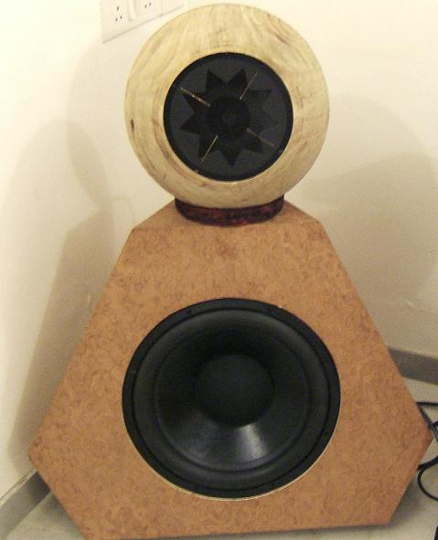

... Not quite 'Aliens" ... but this were the beasts that I concocked last year. The Head unit in picture is one of the prototypes made from Mango wood (or at least I think it was mango?!).
I've gone for something a bit more geodic for the final Teak versions.
I reckon they will appeal to those with mild astigmatism =)
Tuckshop
