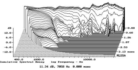

I'm fairly certain that the reason you prefer the Manger over the Piega has to do with Spectral decay and nothing to do with dispersion. The Piega's dispersion is also quite poor over most of its bandwidth. (Note that most true ribbon tweeters have excellent dispersion horizontally - something I suspect that the Manger does NOT have, and know that the Piega does not have. Where they often lack dispersion is vertically, but this is a distance vs. linesource characterstic, not a ribbon characteristic per se.)
Take a closer look at the CSD's of BOTH drivers. First notice the INITIAL decay. The Piega's is longer (worse). Now look at the level where artifacts occur and sustain the driver's decay. The Piega is about 12 db's down when this occurs from 2kHz up on average. The Manger's is at least 3db below this on average(better). The ONLY area that is markedly superior by the Piega is at about 1.5kHz (and the Manger sustain here could be an enclosure related artifact). What is perhaps even more important is NOT the treble, but is in fact the upper midrange. Note that throughout most of this region in the Manger that you have an ASTOUNDING 12 db of "clean" decay on average, (something the Piega doesn't even come close to). Chances are THIS is what your girlfriend prefers (..and so would I). This is also a reason why they will be difficult to "integrate" properly with a woofer.

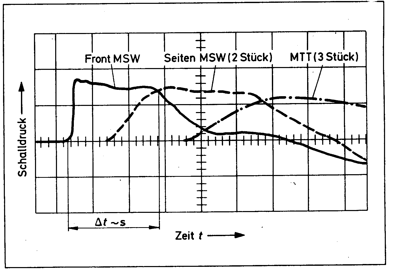

I never saw a schematic of the crossover of this 3 Manger driver design.
I just digged out an old paper - it doesn`t specifiy any frequency or slope related thing. Only that the left and right driver can be "level-adjusted" individually and both adjusted "in terms of frequency above 3,2kHz" to avoid/tame short reflections due to nearby positioning the speakers at room boundaries.
On the attached diagram the time axis is not scaled, however You can see from the reduced risetime of the middle curve (=2 side firing Mangers) that there must be some sort of low pass filtering involved.
BTW: MTT (right curve) means Mitteltiefton = woofer/mid drivers.
I have to correct myself somewhat. The reduced risetime on the graph above could also result from the fact that the sidefiring Mangers are already beaming and when the MIC was in front of the baffle that it therefore did not capture a good part of the high frequency waves of the sidefiring drivers.
By all means I can remember that some sort of electronic filter is involved for the side-firing Mangers and the text in that paper about "correcting" the high frequency response above 3,2kHz does indicate this also.
They use a first order LPF on the additional (side firing) MSWs. IMO the same thing could also be done cheaper using good conventional low-mid drivers (look at the Audio Physic Kronos).
