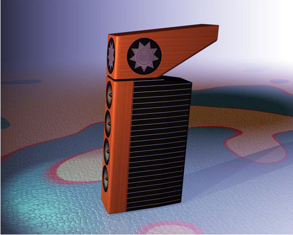

Ideal volume and ideal shape.
I was pondering about that a little while ago.....
the result can be seen below...a volume which takes care of backreflection as good as possible.
For some reason I called my design "Alien".....
Tuckshop,
this is not a finished speaker but a raytracing done on Alias Autostudio 3D-software, so kind of virtual.
Accordingly no crossover frequencies but based on my listening experiences with the Manger I would always cross them a little higher....like 300-400Hz.
rgrds
Oliver
rgrds
Oliver
