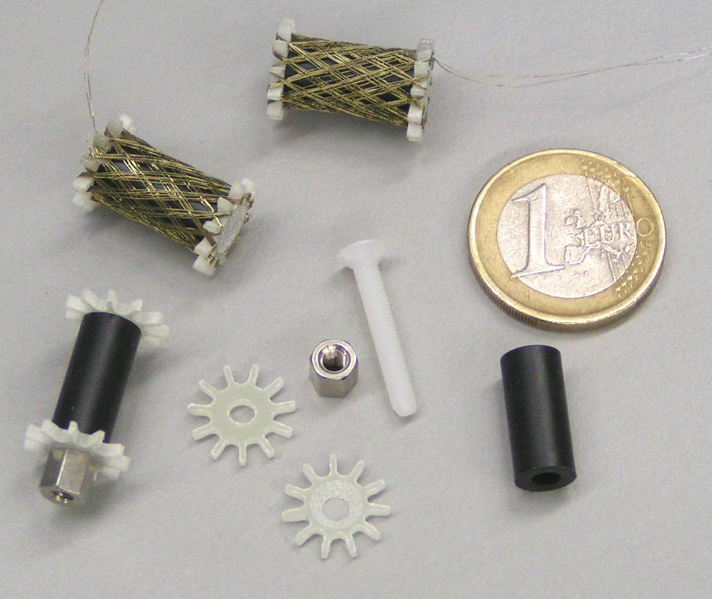

Manganin wire wound resistor diy

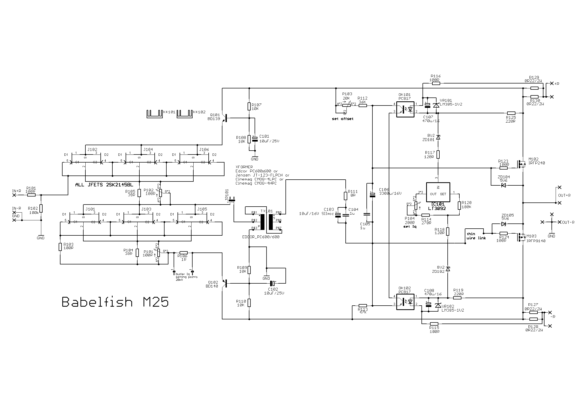

https://www.diyaudio.com/forums/att...nd-resistor-diy-babelfish-m25-2-schematic-png
Hi Jesper, I am beginniner for electronics so not understood
but parallel 0.22R instead of avoided source resistor?

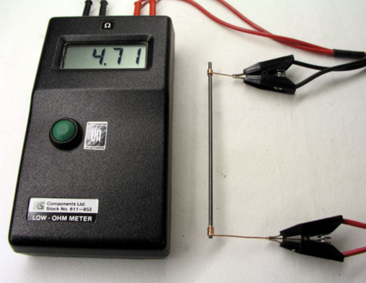

JMFahey,thanks for info.
The problem was I don't have ohm meter for such small resistance.
Good to know constantan wire is easy to fix resistance value.
Nicoch58,
Your resistor looks super.
I will look for that toothed gear.
I made my own, easy peasy, just a 100mA constant current source and measure voltage drop with a standard multimeter, which now becomes a sophisticated 4 wire ohmmeter, but it´s actually NOT NEEDED 🙂
1) I measure 1 meter of wire to get the ohms per meter, then it´s easy to cut a few cm as needed, only precision instrument required is a ruler.
The worst quality one I can get (50 cents at the Dollar Store) has 1% precision (1 mm) on the 10 cm scale 🙂
2) but not even that, you CAN trust the ohms per meter rating specified by the wire seller, and which is usually printed on the wire spool itsef.
