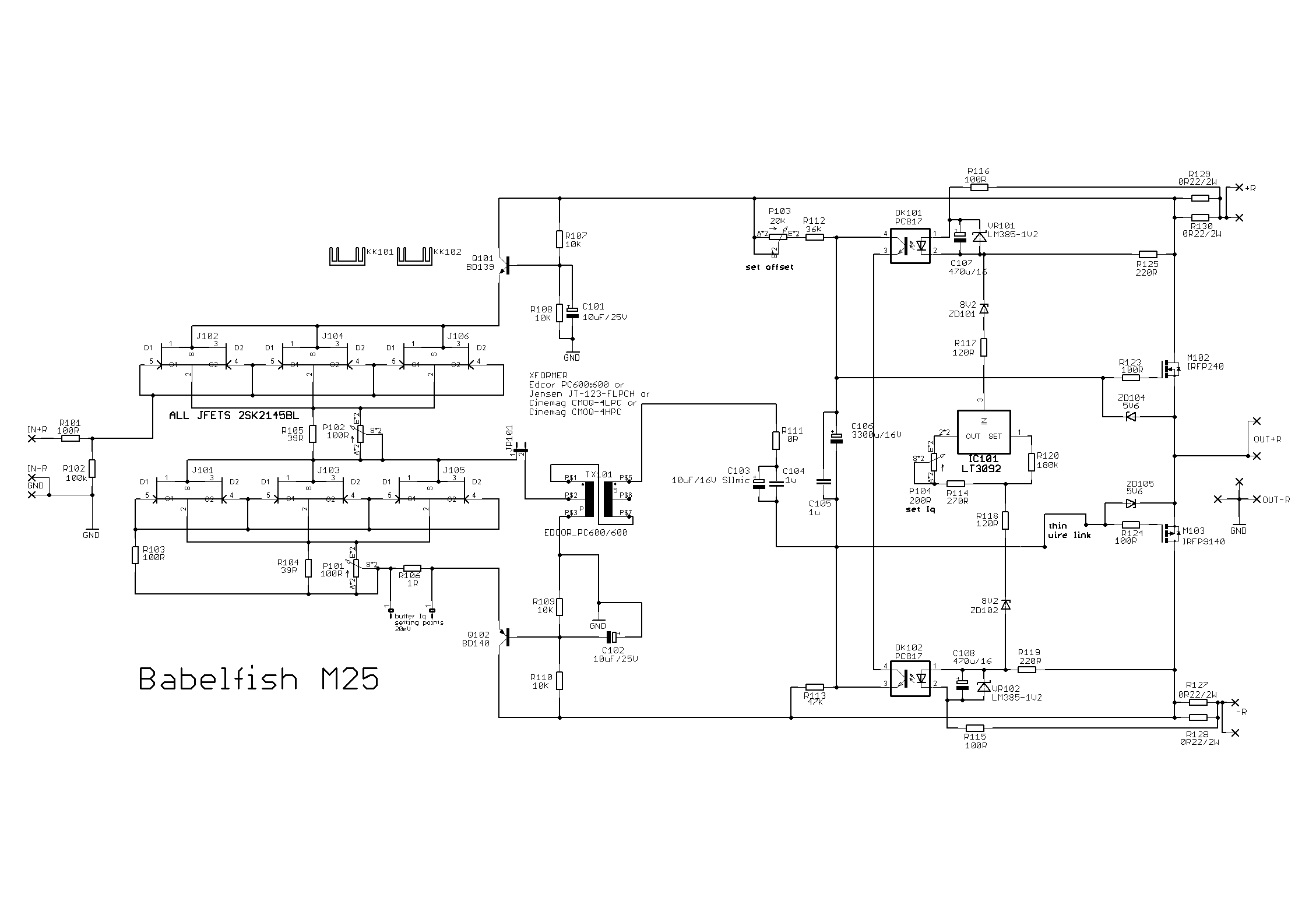

https://www.diyaudio.com/forums/att...nd-resistor-diy-babelfish-m25-2-schematic-png
Hi Jesper, I am beginniner for electronics so not understood
but parallel 0.22R instead of avoided source resistor?

... No, I just hadn't seen your schematic so I did not consider that you were thinking about the source resistors. So, no worries ... ;-)Hi Jesper, I am beginniner for electronics so not understood
Jesper
