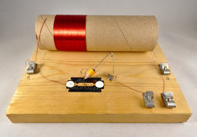

Actually 100 ohm in series with 100k to ground does *nothing*, certainly nothing audible.
On the other side, the unnecessary inductance you added in series with combined FET gates capacitance, which is huge, puts a tuned circuit at your input.
You are in high danger of picking a TON of RF interference, in exchange of no advantage.
What you built was already made by POWs in Japanese prison camps, in WW2, to listen to Allied broadcast Radios , to hear News about War or simply good Music.
Notice the extreme similarity:
EA2V-o4XUAAO5nc
Coil wound in a cylinder? ... check
Detector? .... any non linear junction, such as GS in those Fets.

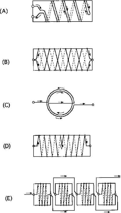

I wound like A on figure,I will try B next time.

tamra, I just realised you haven't been applying the inverse law of sound coloration with the wire you are using. Darker wires provide brighter sounds. I highly recommend you use only grade 1 enamel copper winding wire for your resistors, as that will provide a smooth but not over-bright sound. I would also use winding technique (D) as that keeps all the electrons going from left to right, and not getting them confused about which direction to take, or what is happening with the other winding wire in (B) or going backwards in some sections like in (E). It always helps to use correct and simple first principals.
Hmmm ... just curious here as I am not sure what you are saying here? I would assume that adding a dark sounding wire directly in the signal path would cause the sound to become "darker", whereas adding it to ground (e.g. the 100k input resistor in tamra's circuitry) would cause the sound to become brighter - "darker sound subtracted from main signal = gives brighter main signal" ... everything else being equal, of course ... or might I have misunderstood something here?
Cheers to both of you ;-)
Jesper
