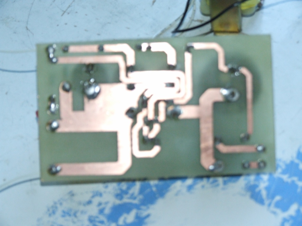

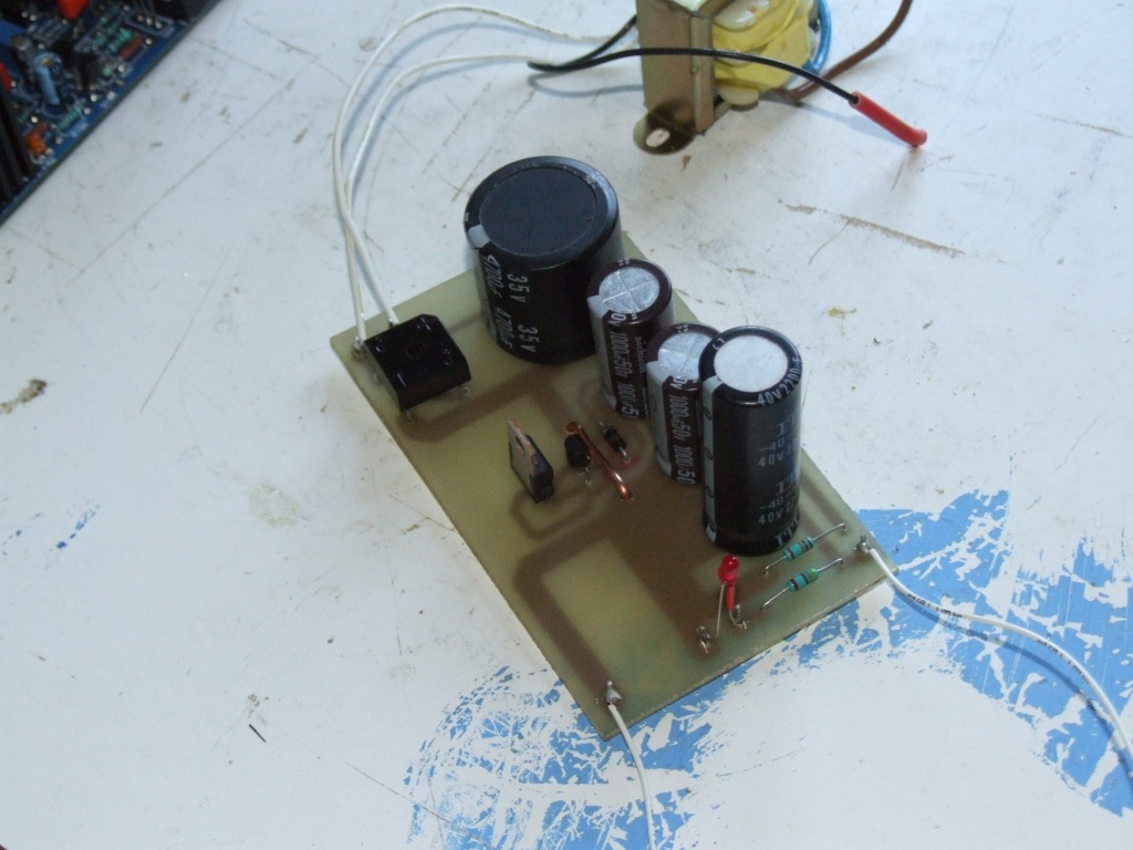

This wasn't a complex design.
A simple laser printer was all that was required.
I'm sure, with a bit of practice, more complex designs could be achieved.

This is a simple design, how would it be with more complex designs.
C1 should have been moved to the lower left hand side. Then the traces would have worked out much better. It's always important to lay traces out so they are as direct as reasonably possible. Jumpers would have been better for that layout in the event C1 had to stay there for some reason. Your traces are also a bit close.

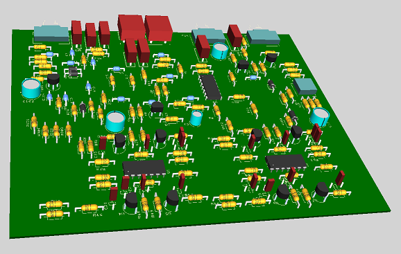

There are so many better solutions than MS Paint. I'm currently giving the free DESIGNSPARK program a try and it seems to work very well. There is a basic tutorial for schematic capture and PCB design that any new user should do, it is easy:
DesignSpark | The gateway to online resources and design support for engineers
There is a section on the site for additional parts libraries, and you can also import Eagle parts libraries.
It will make a 3D view of your board at the push of a button as you can see below. This is a copy of the discontinued Ross Compressor guitar pedal that my son is going to build:
