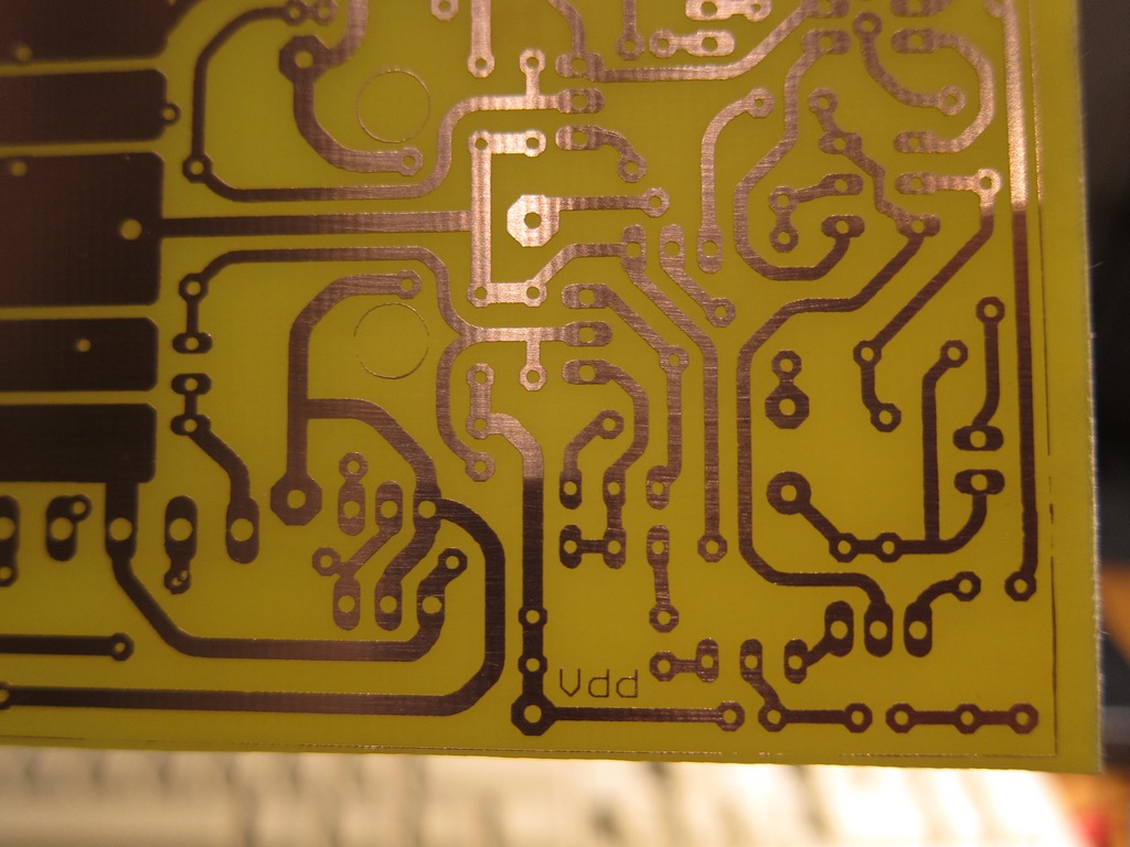

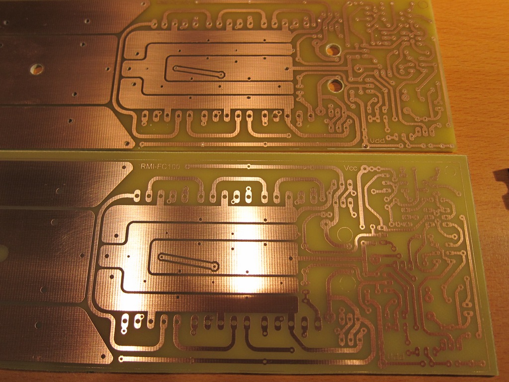

I was blessed recently with good photo paper and here's what I am getting pretty easily out of my Samsung laser printer.
Paper peels off when cooled down to room temp, leaving plastification on top of toner, protecting copper perfectly. Letters and circles on the photo are 2 mils, tracks are 32 and 50. 10mils can be done in a snap.

What are the specifics of your method? Did you iron on or use a laminator? What was the paper?

The one thing that might be critical is the type of paper. I am in Belgium, so if you are not, you are very likely not to find the exact one. It's actually cheapest, noname brand sold in Makro/Metro around Europe called "Aro". It's semi-gloss, medium thick.
The PCB is prepared by 000 steel wool and wiped off with acetone. Transfer is done with usual Philips steam iron, with no water, hottest setting. Printing is done with Samsung ML1640, with refilled toner (not critical for success). Darkest setting, economy off, 1200dpi. Paper is a bit hard, so it could happen that cheap 40eur Samsung either gets stuck or paper moves while printing. Check geometry of the print afterwards, especially if you are doing double sided boards. You might be luckier with better printers.
I press paper with iron without moving for 15s or so, to make sure it sticks to the pcb first. Then I start sliding over it with iron's edges, the straightest one you can find, to maximize pressure on every spot. I then alternate flat ironing with "edge slide", making sure I cover all of the surface. My iron's edges are not straight, so I am planning to find one with at least one straight edge. I keep alternating flat and edge ironing, to prevent pcb from cooling down during the process.
Pressing is done after 5mins or so. I leave it to cool down to 20C, then I start taking the paper off slowly, by keeping one finger at the paper, sliding it as paper detaches. I pull the paper with other hand, to prevent violent detach that might pull toner off. I usually put thin 2mil edges around my PCBs so that I have and indication that things will stay in place when I start pulling.
Cut with hacksaw and soak in FeCl3.
The whole process is done in half hour time. Remove toner with acetone.

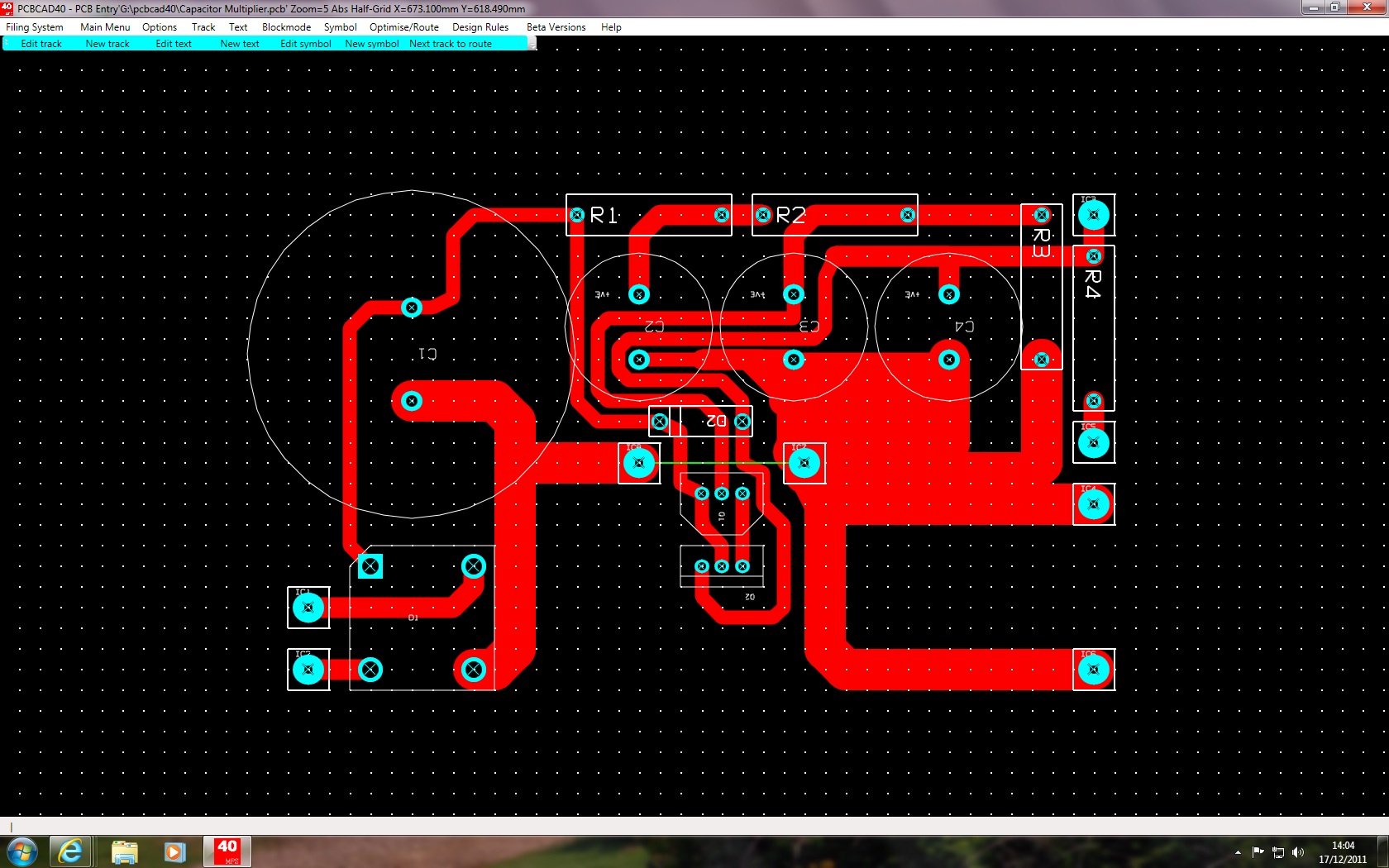

I found this method fine for audio work where track clearances are about 15 thou, however, I did have to run a sharp knife between some of the closer tracks.
If you do this before etching it makes for a better finished product.
With my design there were problems with tracks touching each other.
This is a simple design, how would it be with more complex designs.
