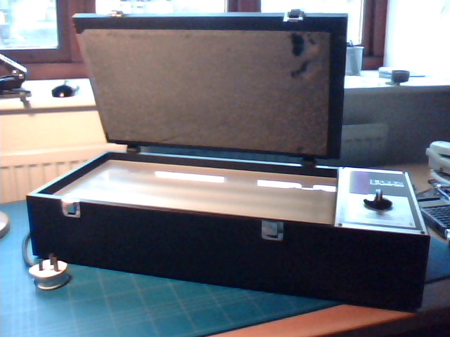

Unused UV Light Box
Hello,
I have an Ultra Violet light box that hasn't been used for a long time. The specifications are:-
Model: Decon 415, Type: UVL-415
Exposure area = 470 x 255 mm, 4 off 15 W tubes, total power 60 W.
Overall dimensions = 625 x 290 x 130 mm excluding hinges and catches
Clockwork adjustable timer, 0 to 6 minutes.
A quick, not recommended, glance at the Ultra Violet light shows that it's working.
The foam on the lid has gone all crunchy and is turning to dust.
It's made of chip board so it's heavy and will need to be collected.
It's free to anyone who can make use of it.

Crunchy foam is no probs. Scrape it off and replace with egg box foam.
Tubes need to be replaced regularly though.

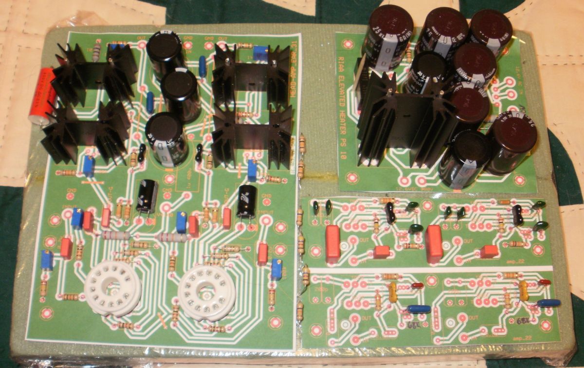

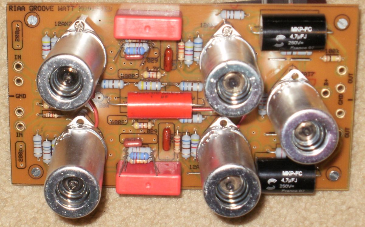

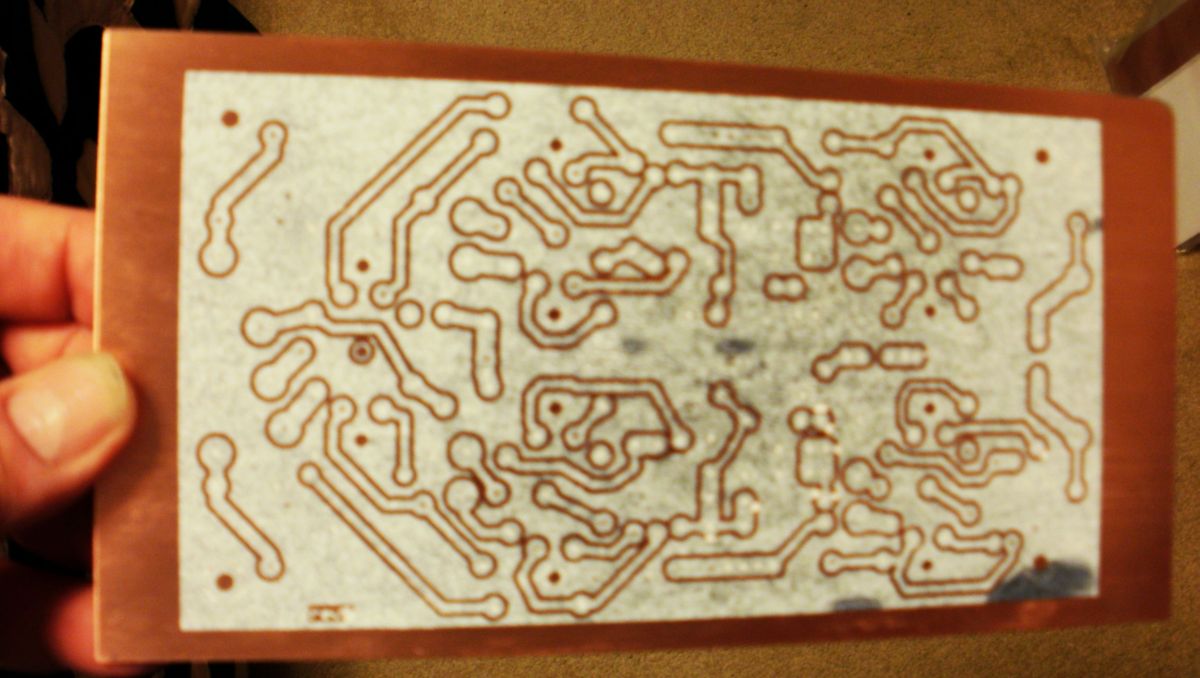

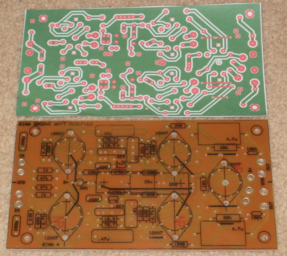

toner transfer PCB
Still at it with the next project, RIAA preamp. Toner transfer method as my previous post. The last pic is after soaking the pcb in cold water to allow the paper to disolve and lift from the melted toner on the copper. All that is left on the top of the toner is a layer of the clay from the paper. If there are any small voids, I use a paint brush with modeling enamel and do a little touch up. The top of the PCB is black toner with the white clay layer removed. If you scrub too hard, you can remove the toner as well.
Also working on a hybrid tube Mosfet headphone amp with boxandall tone section and a couple of power supply pcbs.
I use green stiff floral foam to mock up the pcb to verify component count and lead spacings. When the PCB is etched and drilled, I just transfer the parts to the PCB.
