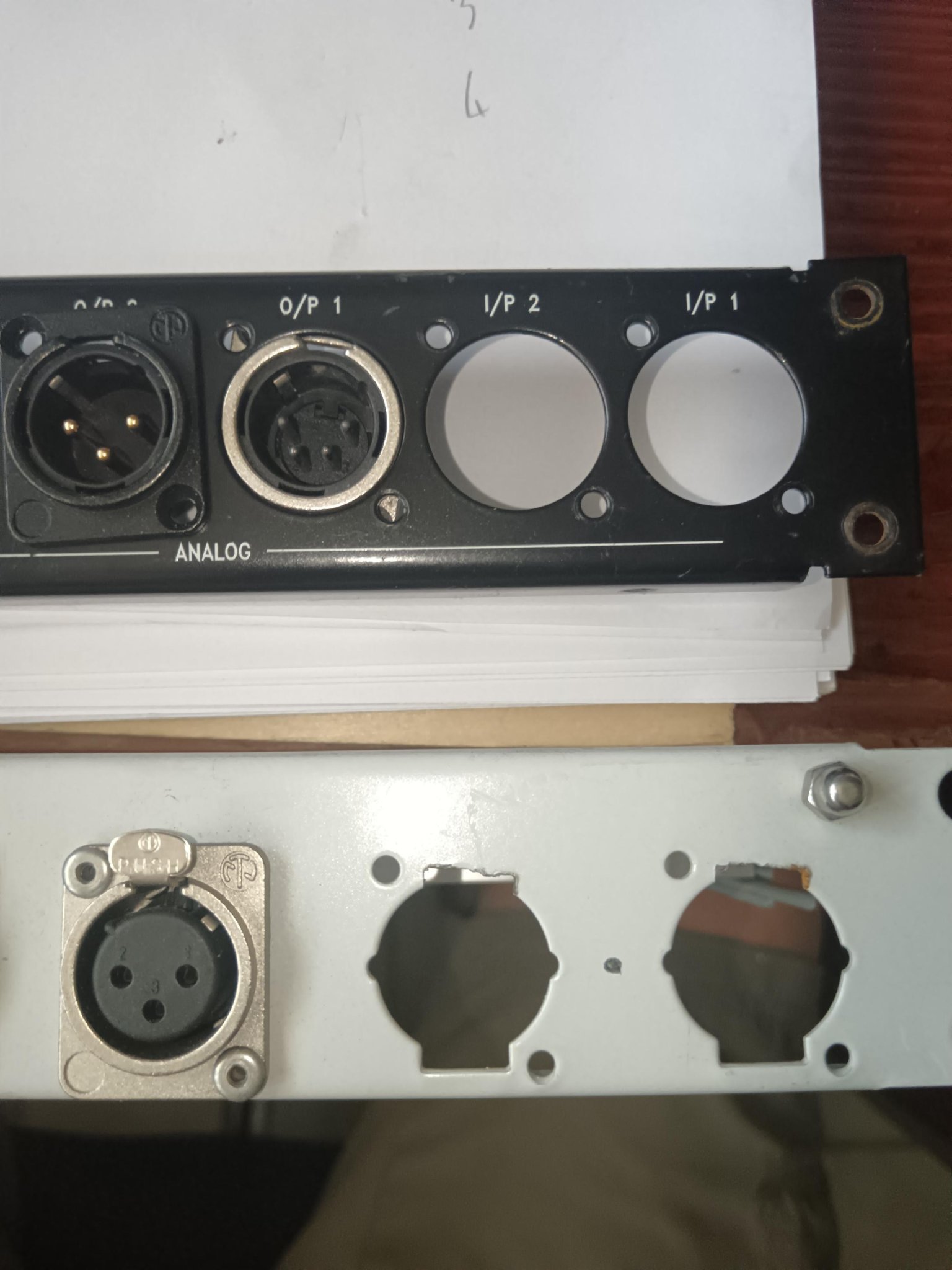

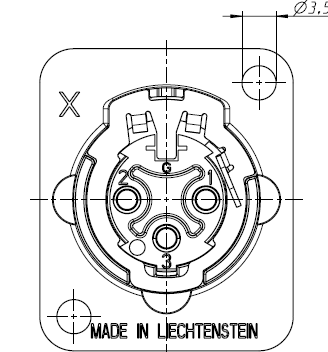

This is universal Neutrik, 21.5 mm barrel with 4 slots, 3 small ones for centering and one large for release lever
If one makes just one 23.6 mm hole (24mm is also ok) XLR can be mounted from back or from front regardless, Pins fall in hole diameter then and have no function, socket is centered by mounting screws only. See black panel below, one socket from front and one from back.
If we make tighter 21.6 mm hole (22 is ok) than slots are needed and XLR is centered. , See gray panel below, on this one someone opened large second vertical slot too to make possible upside down installation as well.
