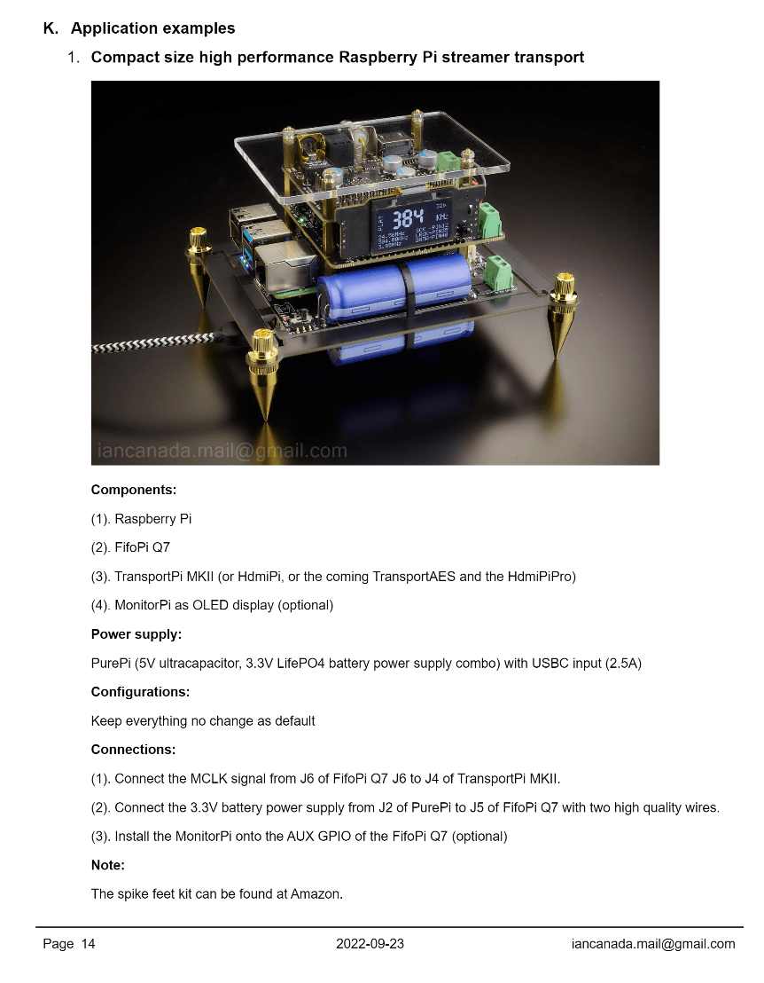

Making an Ian Canada streamer
I'm building the streamer using these instructions
However, all I need is a spdif out to the DAC.
I understand that I can use the TransportPiAES board instead of the HDMI board. But I'm trying to cut costs - can I use the TrasportPi MkII instead? The author mentioned it, but it looks like it's a different shape. Will it fit? Or what can I use for the spdif out with this configuration?
Thank you

I recommnend just going for the TransportPiAES. It's an upgrade from TransportPi MKII and has an last stage re-clock before output.
If you already have the TransportPi MKII, you can stay put as it's a sunk cost.
I have both the TransportPi MKI and TransportPi MKII, so they are already sunk cost so I can't justify a TransportPiAES ATM.
If you are starting fresh, just go with a TransportPiAES because a TransportPi MKII will be an opportunity cost.
If you go for the TransportPi MKII, that's a $79 opportunity cost. So use that cash for the TransportPiAES @ $139 - $79 = $60 more.
The output of the TransportPiAES follows the RPi USB outputs. The TransportPi MKII outputs to the left side of the RPi. Unless you have a specific use case to output to the left of the RPi, TransportPiAES is the way to go as it's an upgrade.
I don't see a need for a HDMIPro if you are just in it for S/PDIF OUT.

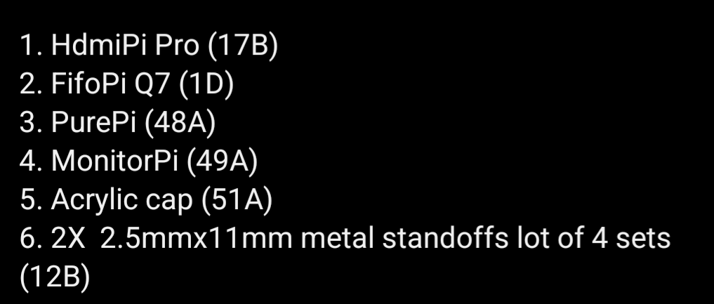

So:
  1. Q7 $189
  2. TransportPiAES $139
  3. PurePi MKII $97
  4. MonitorPi Pro $75
Total is $500. If you join the Group Buy, it brings it down to $450. The $50 savings is close to the $60 TransportPi upgrade.

Don't worry about the fit of the TransportPiAES, it's a little longer but it balances out with the length of the RPi. All of Ian boards comply with the RPi 40-pin GPIO standard. The TransportPiAES is just a bit longer to fit in the AES.
