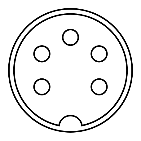

Mine looks like all the pictures of a srd-5 except my plugs and leads and extension lead have what look like higher quality plugs on them, that are definitely not compatible with Stax 5 pin plugs as the it looks to me like a shielded 5 pin din as attached. I expect this is old work, probably before 1980, as I have only seen such solid construction of plugs and sockets on very old equipment. This "upgrade" is exceptionally well done work around for the lack of Stax Sockets, though today I would use a very different design of plugs, and I definitely doubt Shielded DIN plugs are not rated at 230 V RMS. When 5 Pin XLR plugs are rated 125V RMS, or maybe these are an older standard. It might have serial number 9059.
Regards
Owen

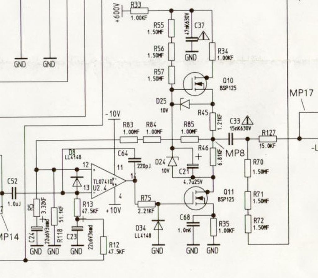

I don't remember what thread I posted the Stax's schematic in but here are some links to some drive circuits and info for a start.
Thank you these links, they are interesting, and please don't think that because I continue down this path that I am dismissing direct drive.
For a direct drive system, I guess the power supply without custom/valve/tube transformers, one will need 4 normal mains transformers, one to step down for the low tension circuit, and three in series to step up for the shared high tension power supply. For duel power supplies its still going to need 8 mains transformers though the quality of these transformers should have no effect on the sound if within their specified limits.
I may look into building one or more of these circuits later and see if they improve on the basic transformer solution. At this stage I am still attaching wires to all the transformers that are now mounted and the primaries and secondaries attached to terminal blocks. Step by step, little by little this little step up system is coming together.
