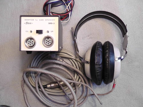

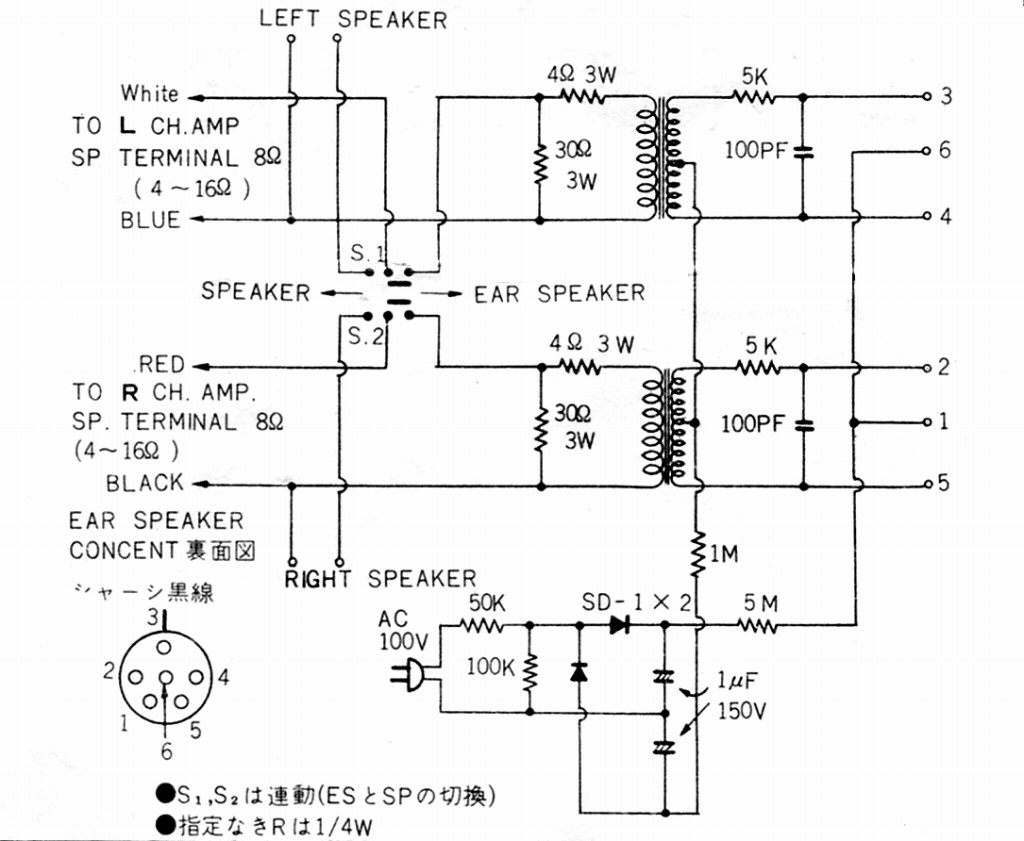

I picked up a cheap STAX SRD-4 which is an designed for electret headphones, so I think it does not include the HV bias of a normal or pro stax headphones. This is not an issue as I have successfully built HV bias supplies on breadboard for the torroidal step up transformer circuit. Good news though is it does have a genuine 5 pin pro socket 🙂
The SRD-4 also contains a pair of transformer for stepping up the output of and amplifier, (1:50 from what I have read) and these are common on ebay at cheap prices. I will make a small box, to put under the SRD-4 and drill a socket in the bottom or side to pass the HV in.
This seems a cheap solution to the transformer solution and is a LOT smaller than 8 X 30 VA torroidal transformers. I will let you all know how they compare later.
Developments on the SR-3 and SRD-5:
I have mostly been listening to this system (late at night) while I built the supplies.
The SRD-5 started to hmm a lot, after a few hours listing, (rather than a little as before), I guess the capacitors are showing their age worse than I am, but they are older. So I took out the transformers, noting that Stax had been cheap and no terminal connectors on the transformers which is saving them a little money but not making fixing easy as fragile primary and secondary winding can easily be broken. To solve this I hot glued a 2 and a 3 way PCB terminal block to the top of the transformer and replaced the capacitors which I could now access without the transformer blocking access.
Sadly my stocks did not have 1uF 190 V capacitors so it only got 0.1 uF on the HV bias, this means that it wont blow up but sadly does mean that the main hum is still with me for now, at about the same level when pluged in so I guess the original electrolytic had about 1/10 of their value. ( ifdidnt
I cant help thinking the AKG's have better, cheaper and most importantly more comfortable ear pads than with either of these Stax headphones. I do suspect I might end up building some electrostatic headphones before the year is out designed to use AKG ear pads (easy to get as spares for a reasonable price).

An interesting site showing some stax models and some schematics.
I have attached the schematic of the SRD-5 so it does not get lost.
Regards
Owen

The SRD-5 and SR-3 that I got at a good price from ebay arrived today and I am pleasantly surprised how well they work in their original state. From what I have learnt already I can without doubt improve the SRD-5, and it should immediately have its capacitors replaced as although they don't do much work, and will have little effect on the sound, but they are older than me and could blow at any time.
The capacitors arrived today by post for the SRD-5, and other components for the potential divider, (so measurement can start) and some resistors and capacitors to adjust my Lambda drivers.
So I set up my Quad 303.
I have just been listening to :
Tchamantché by Rokia Traoré
Stairway To Heaven by Rodrigo Y Gabriela
Malka Moma Dvori Mete by Chet Nuneta
and I am very pleased.
The hum is gone and the sound is exceptionally good, bettering all my experiments so far. Subjectively it is better than the too bright high notes I had with my previous experiments.

(a) In the circuit in the SRD-5 the bias that charges the electrostatics is driven direct from the mains in an asymmetric way, with no decoupling transformer, so plugged in one way it generates hum, and one way not (German plugs can be plugged in swapping live and neutral, something I have found most hifi/musical people dislike but most consumers have no problem with) I will at least partially solve this my moving the plug to the IEC type.
(b) The SRD-5 plugs are not Stax plugs but have been replaced with high quality 240 degree din plugs with screw plugs. (now its confirmed they are screw locked Din plugs as I found a 240 Din plug in my stocks) I am unsure I can be bothered to change this in the short term as they don't look too dangerous and my Stax plug will be difficult to attach as safely to a cable.

First i have to tell that the original Stax transformer in the SRD-7 has a 1:60 step-up. Mine has 1:50.
A esl transformer is a push-pull transformer so it has a + and - fase. In fig. 1 you see that the Stax transformer has not equal fase response for the high frequencies. This is one of the reasons i would like to have a better transformer. Secondly i would like to have a transformer with very low losses. Third i like a transformer-esl combination wich is easy to drive with any amplifier so impedance should be high even at 10Hz or 20kHz
I use for my headphone 500V polarisation. I not use a 1 Ohm resistor but a 0.47 Ohm, i just use a 1 Ohm for measurements. Adding a series resistor is not good for the low frequency response and also give more distortion.
The next stage of my tweaking the home made driver will start soon, thank you for giving me some advice on the resistance range.
The current circuit on the SRD-5 has 4 Ohm in series and 30 Ohms in parallel with the low tension in the transformer. But I guess their designs had to work with Amplifiers designed for 16 Ohms, and compromise on sound for universality and not breaking amplifiers?
The capacitor, in parallel with the headphone is not understood my me? Why is it like that? AM I right with my first guess that it was making the speakers have a low pass filter, the more I think about it this explanation it seems wrong, and since the headphones behave like a very non ideal capacitor why add more capacitance to the high tension?
